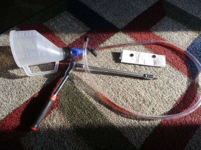

    I went to the dealer today and bought 4 qts of ATF WS and the transaxle drain and fill plug gaskets. They didnt ask any questions or try to up-sell me. Total $43.69.
    The gaskets appear to be aluminum or some pot metal, I assume they are crush washers. Do these look correct?
    I also bought a harbor freight transfer pump and plan to pump the fluid in as described after draining.
    Saturday morning will be busy.

    They are right as near as I can tell from the picture. They are aluminum which is commonly used for crush washers instead of copper.
