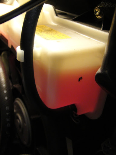

    Inspect the radiator, engine coolant pump, and hoses for leaks, you would see pinkish or whitish stains. Inspect the air conditioner plumbing for oil leaks. No pressure gauge is required.
