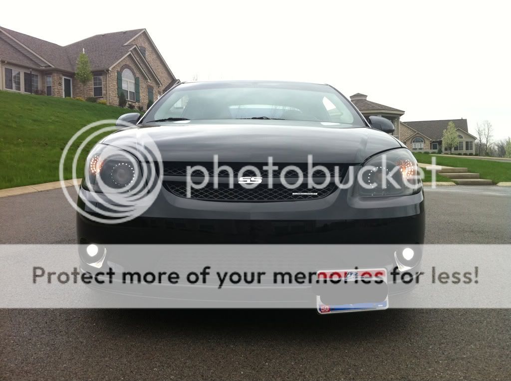

    I would like to use these updated headlight assemblies for a projector retrofit which involves adding individual LEDs to the false LED "nubs" found only on the 2007+ headlights. I'll also be adding a CCFL (Angle Eye) ring mounted behind the projector shroud.
    LEDs like this.
    CCFLs kind of like this.
