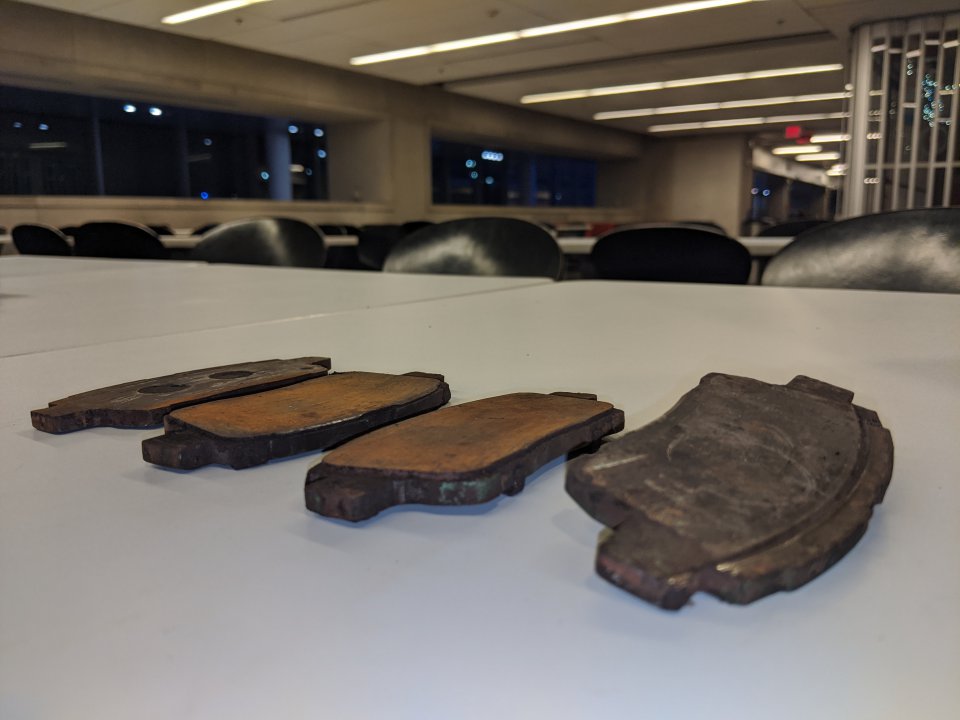

    Just changed the brake pads with Duralast ceramic brake pads (cost including tax was $36.37 and came with a lifetime warranty) from Autozone by myself. Kept the same rotors. This is my first time doing the brake job by myself. It took a little over an hour on both sides in the front, and it wasn't difficult. The squeaking noise is gone now. Attached are pictures of the old brake pads that I replaced. Saved some $$$.

    Yeah, that pad on the left has no friction material on it–it is right down the metal. You found the cause of your squeaks.
    I'd be surprised if you didn't also damage the side of the rotor where that pad was located.

    No damage. I was prepared to replace rotors along with the brake pads, but I felt the rotors were fine. The rust on the rotors in the pictures in the OP is just surface rust. I felt that the rotors will last for another 50K miles, at minimum.
    The ride I heard the squeak was the last ride. A few years ago, I kept driving my Toyota Corolla, despite the squeaky noise, and the continued driving screwed my brake piston caliper. I had to spend some additional money to replace the brake piston caliper along with the brake pads and rotors. I learnt my lesson. This time, I stopped driving immediately after I heard the squeak in order to prevent further damage to other components.

    Here's what's weird to me in that picture: on one pad of each pair, there's supposed to be a little spring clip with an end that bends around and points toward the rotor. It sticks about a millimeter past the metal backing of the pad. Its whole job is to make a shrill squeaking noise as soon as the pad is worn down to that last mm, so you know it is worn, well before the pad is all gone and the metal is touching the rotor.
    I don't see that clip on any of those pads. Were they there and you pulled them off before taking the photo? Or were these already some aftermarket pad that didn't have them?

    I was thinking the left end pad was upside down??

    The clips were there, but I just didn't take the picture of the clips. I just wanted to show you all and others the wear and tear on the old brake pads who might come here for help in the future with a similar problem.
    Possible. I am inexperienced person in these sort of things. The top of the brake pads as it shows in the picture were touching the surface of the rotors and that's where the brake pads were worn.
