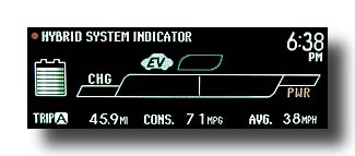

    This new EV symbol just introduced with the 2012 model indicates when the engine is not in motion:
    Both the v and plug-in models have it too.
