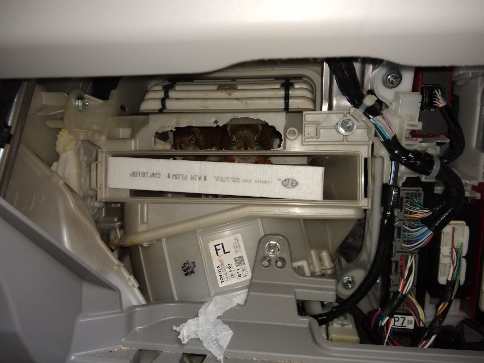

    Clean your hybrid battery cooling fan for it's own sake... Rodents are know to make it easy for stuff to get sucked in there, but they probably can't get in there themselves. But you be the judge of how this particular Prius poster's pic happened:
