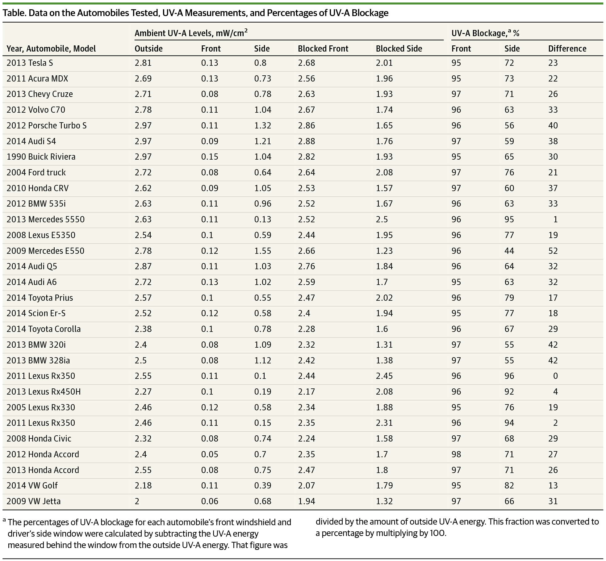

    So helpful!!! I wonder what "UV" means, UV-A or UV-B, or...?
    What's interesting is this study from 2016 that looked at 29 cars from 15 manufacturers of varying ages, price range, car types, etc. and they reported the actual %UV-A reduction. 2014 Prius measured 96% UV-A blockage of front windshield and 79% UV-A blockage of front side windows... much less than the specified 100% / 91%. Guess I'm getting my windows tinted!
