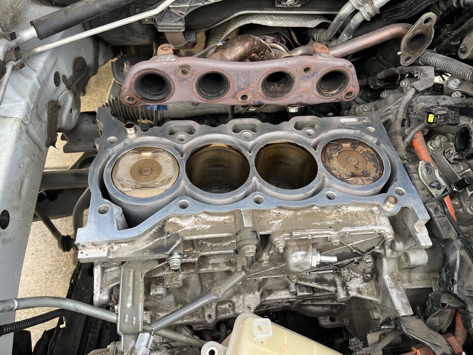

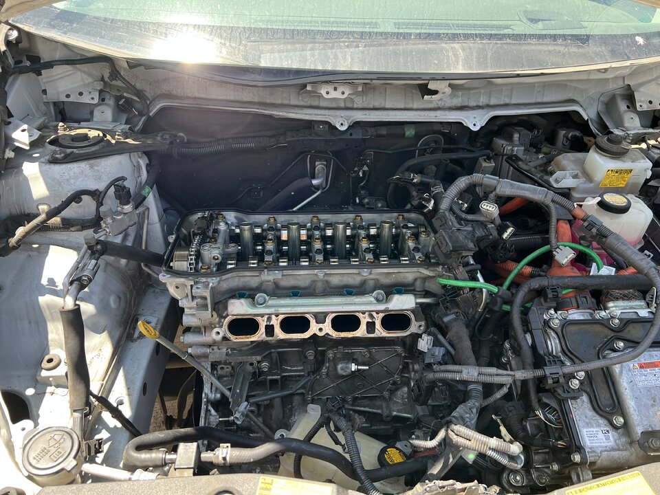

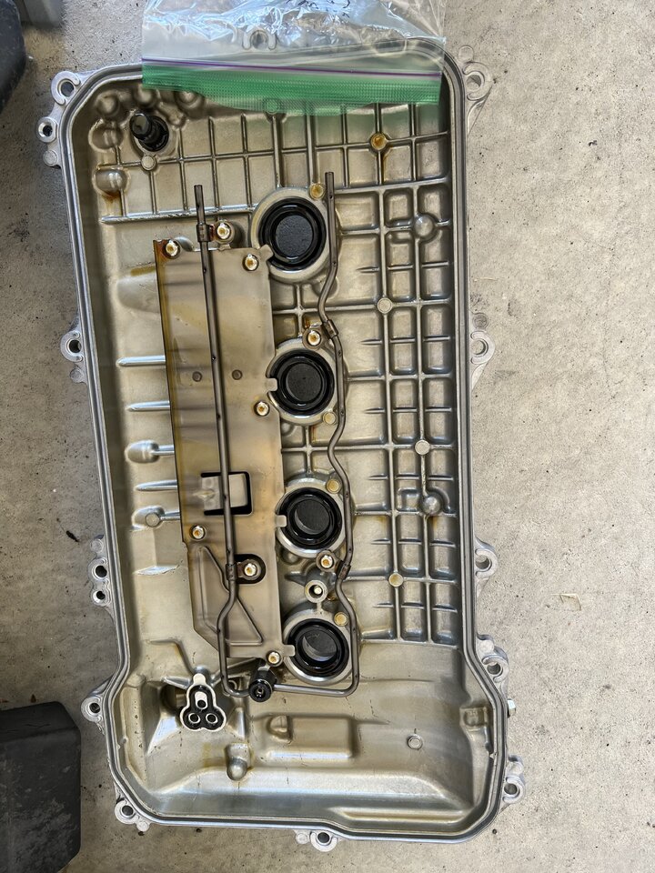

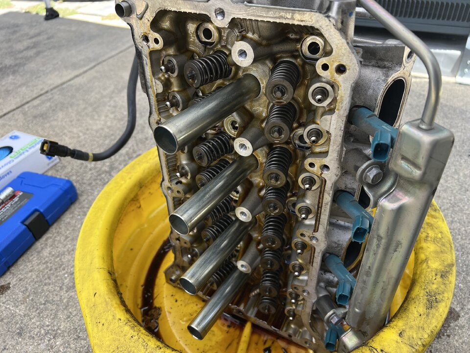

    I do 10k miles interval since I had the vehicle. It’s at 284k, changed every 10k with mobile 1 synthetic 0w-20 oil. Take a look at my valve cover, camshaft housing, cylinder head and block, they look pretty good with those miles interval oil change. You decide how many miles you want to change yours, I’m sticking to 10k.

    Impressive work on the head gasket @NutzAboutBolts. I agree that full synthetic oil really clean the engine well. My Altima 02 that has blown head gasket at 70k miles was also really clean, but it consumed engine oil 1L/1200 miles. What I cannot see is the condition of the piston rings, especielly the oil control ring. It is probably the hottest place where the engine oil must endure and oil analysis won't reveal the carbon formation there.
    You reached 284k miles for 2012, it means your 10 000 miles is almost on ideal driving condition, not in freezing cold north, nor extreme heat Spain or Greece. I will also do 10 000 miles interval if I drive 20k miles per year.
    I prefer to use 4L more per year than burning oil later on. 1L per 1200 miles (Toyota limit) means 5L between oil change poissoning the catalytic converter instead of recycled.
