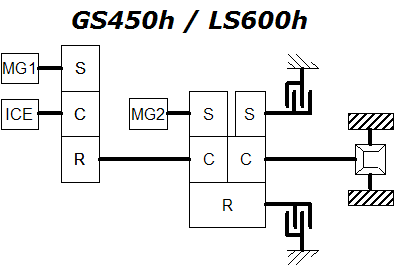

    The transmission in the Lexus GS450h is actually quite a bit more complex than the one in the Prius.
    The Prius is just one planetary gearset, no clutches.
    The GS450h uses one planetary gearset and a ravineaux gearset with two different gear ratios, which are selected using band clutches. Basically there are two gear ratios that can be selected, for high-speed or low-speed operation:
    The Prius single-gearset setup does have performance limitations, which is why for high-performance cars like the GS and LS, Lexus had to add the complexity of selectable gear ratios. Ditto GM and their Two-Mode hybrid transmission.
    Personally, I think if one has to go beyond the simplicity of the Prius single-planetary setup, one starts losing the advantages of mechanical simplicity, with diminishing margins of return on fuel efficiency. So perhaps conventional ICE/multispeed transmission setups are still best when high horsepower, off-road or heavy towing is needed.

    ^ are you talking about a reduction gear in the GS450h?

    GS450h and LS600h have dual-stage HSD, simply for higher speed requirement.

    It does like Prius B mode, but it has six speeds such as B-1, B-2, B-3 and so on.
    If it is selected for low gear, it keeps ICE rpm high for better ICE pick up.
