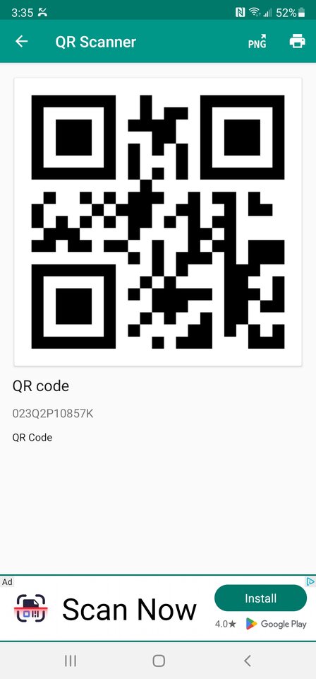

  7. bigblockcutlass
    bigblockcutlass Junior Member
    Dec 9, 2012
    Bought it for $500. All the cells Within .002 volts
    Hopefully I didn't get taken. I guess the place is out of Tennessee. The guy bought from talk to owner of the company was Ukraine.

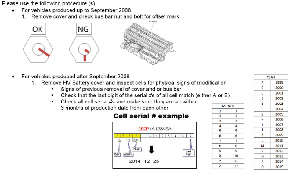

  9. PriusCamper
    PriusCamper Senior Member
    Mar 3, 2012
    13,468
    5,438
    Pacific Northwest, USA
    Looks like a standard OEM Toyota pack made my Panasonic... You can discover date of manufacture for each module using this chart:

  11. Hayslayer
    Hayslayer Active Member
    Nov 6, 2024
    538
    331
    nice, you paid 500 bucks for a battery that has modules with F (2004) and Q (2015) date codes. What a mix.......
    Hopefully, they're at least well balanced with each other, capacity wise. Hope it works out for you.
  12. Hayslayer
    Nov 6, 2024
    538
    331
    If you consider 2004 and 2015 modules to be new................I'm under the impression that a date code of F (2004) is about 21 years old and a date code of Q (2015) is about 10 years old.

  18. Carall
    Carall Active Member
    Apr 22, 2023
    316
    104
    Harrisonburg, VA
    How can someone balance modules made in different decades, made by different companies, and used under who knows what conditions? It's a myth. If you check this balance after 2 weeks of using it in a car you'll see the result of that so-called balance.
    #18 Carall, Dec 8, 2025
  19. Carall
    Apr 22, 2023
    316
    104
    Harrisonburg, VA
    It's time to say bye-bye to modules from 2004-2005 and often to modules from 2006-2007 (as it happened to modules from G1 Prius), unless they are 100-120k miles, but this may not be an indicator if these modules were tormented in city traffic.
