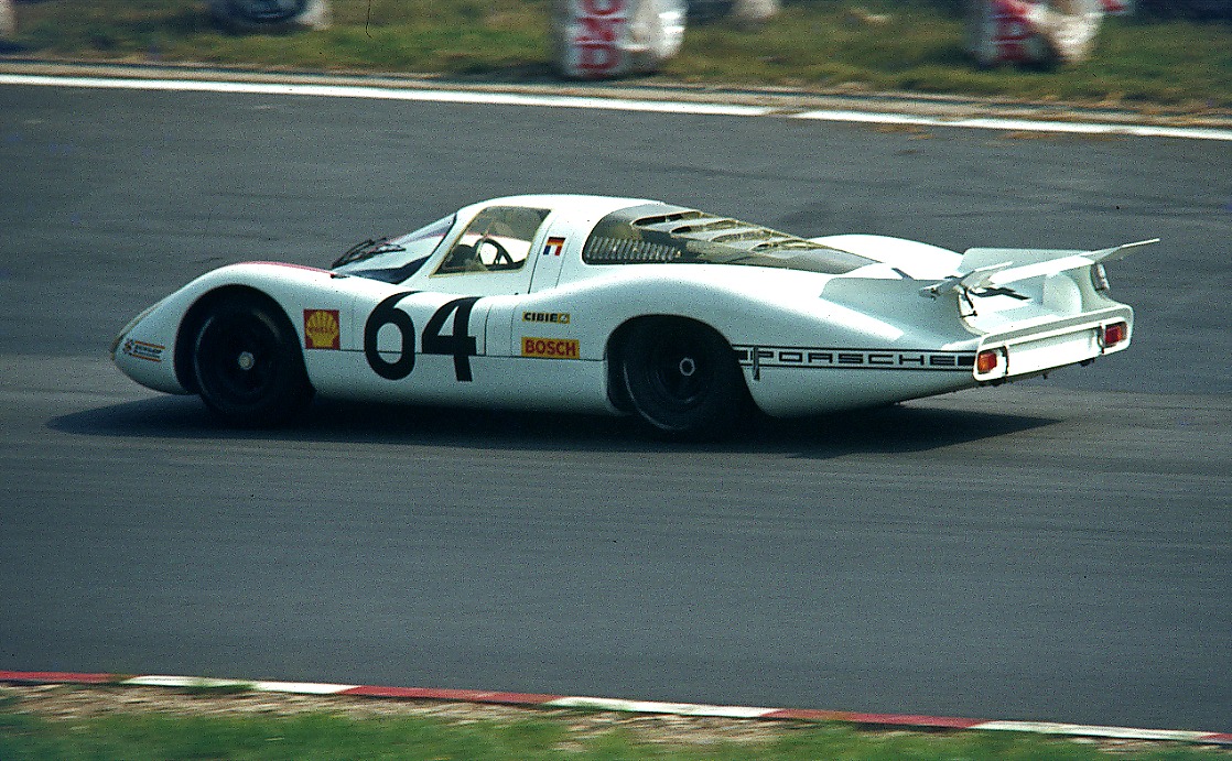

    Porsche tried it with their Langheck tail racers.

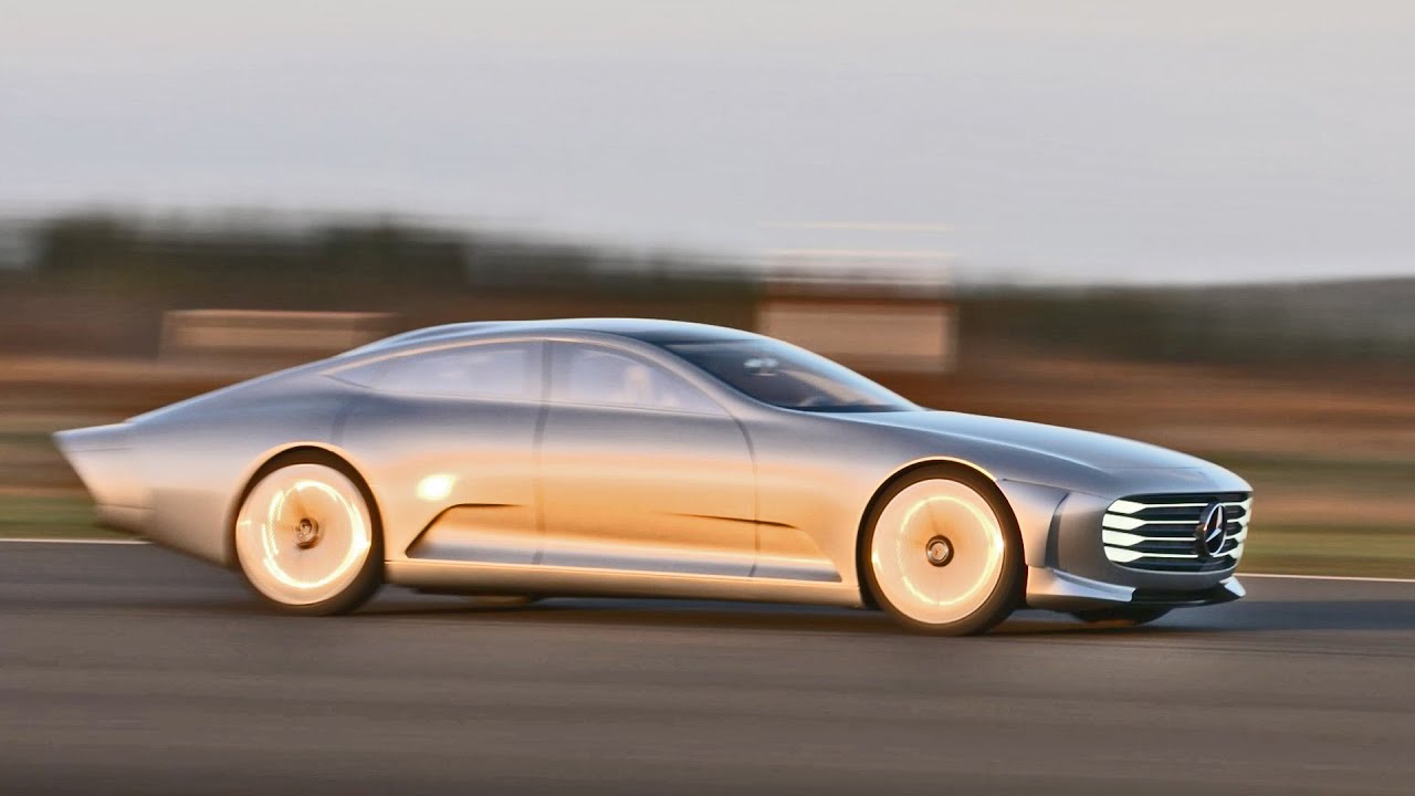

    He or she isn't throwing away any aerodynamic theory; Kamm's design (actually invented by Koenig-Fachsenfeld for buses three years before Kamm published his first description of the design in 1939) was intended to maximize usable interior volume while minimizing drag, not to be the lowest-drag form possible at any cost. As Wolf-Heinrich Hucho described it in his monumental Aerodynamics of Road Vehicles:
    "In essence the result was as follows: Beginning at the maximum cross-section, the downstream contours of the body are carefully tapered so as to keep the flow attached. This produces a steady increase of static pressure in the flow direction. Just ahead of the location where the flow would want to separate, the body is truncated vertically, resulting in a plane base whose cross-section is small in comparison to the frontal area. The wake behind the vehicle is narrow, and negative static pressure on the flat base is moderate due to the upstream pressure recovery. Both contribute to low drag. Looking at Fig. 1.34 the advantages of this so-called "Kamm-back" (or in an often used abbreviation, K-back) becomes evident at once. In comparison to the shape of Lay, the headroom in the rear is far higher; compared to the contour of Klemperer, a good part of the length is saved" (Hucho, W-H. Aerodynamics of Road Vehicles, 4th ed. Warrendale: Society of Automotive Engineers, Inc., 1998, 29).
    Kamm's designs were still high drag by modern standards. He estimated his K3 (1939) at Cd .24, but testing the car (which still exists) in the VW wind tunnel in the 1980s indicated its actual drag coefficient is .37. The ideal length:depth ratio for low drag is somewhere around 4:1 to 5:1, much longer than K-form cars; this is evident when you look at low drag production and concept cars:
    Mercedes C111 III, 1977: Cd .18
    Volkswagen XL1, 2014: Cd .189
    GM Aero 2002, 1983: Cd .14
    Ford Probe V, 1985: Cd .137
    Mercedes-Benz Concept IAA, 2015: Cd .19 (tail extended)
    It's really, really hard--if not impossible--to get Cd numbers like that without a long, tapered tail.

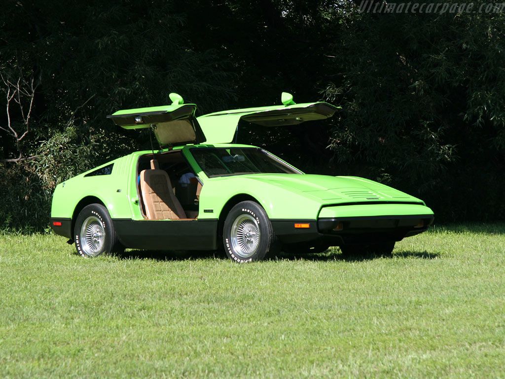

    How about a fiberglass bodies Bricklin SV-1?
