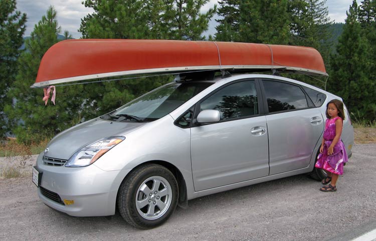

    I think they would have said it if they'd thought of it. But there's only so much you can put in a manual. For example they also don't say to avoid having an elephant sit on your car. They don't say not to pack it full of plutonium. Many things that you shouldn't do that aren't mentioned in the manual.
    If Toyota thought that I was going to do this: http://evnut.com/prius_rack_pads.htm they likely would have included a caution against it in the manual.... again - because it is easier to say know than to deal with something unknown.
    I can see an image like this with a big red line through it in our future:
    And honestly, not everybody should be doing this. Do it right, and you can do it safely. Doesn't hurt the car, and doesn't hurt Toyota.
    If you are worried about adding a hitch for your bikes, don't do it. Don't even think about doing it. I certainly gain nothing from convincing you that it is safe. By not adding one, you're safe, and Toyota is safe. Nothing more to discuss really. There are plenty of us risk takers out here who aren't having any issues with racks or hitches - but that doesn't mean it'll be the same for you.
