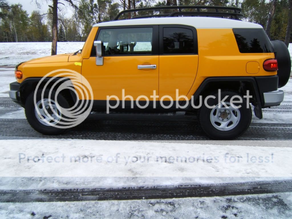

    Tell you what, next time you just keep your freezing rain and your snow.
    Ok?
    At least the factory studded snow tires worked fine
    Check out how shiny the ice is
    When I got out at a rest stop, I immediately went on my butt. I knew my butt was good for something!
    The shiny bits on the front tires are the studs, not pieces of snow. Nokian has an interesting stud pattern
    Typical road conditions.
    I had to turn back from my trip, they had the Trans Canada closed near the Ontario border due to a bad accident
    I strongly advise anybody considering winter tires, to try the new factory studded Nokian Hakkapeliitta 5 for cars, or the Hakkapeliitta 5 Sport Utility for trucks and SUV's. They really do work!
