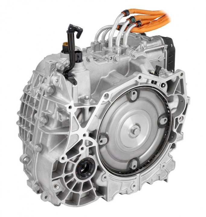

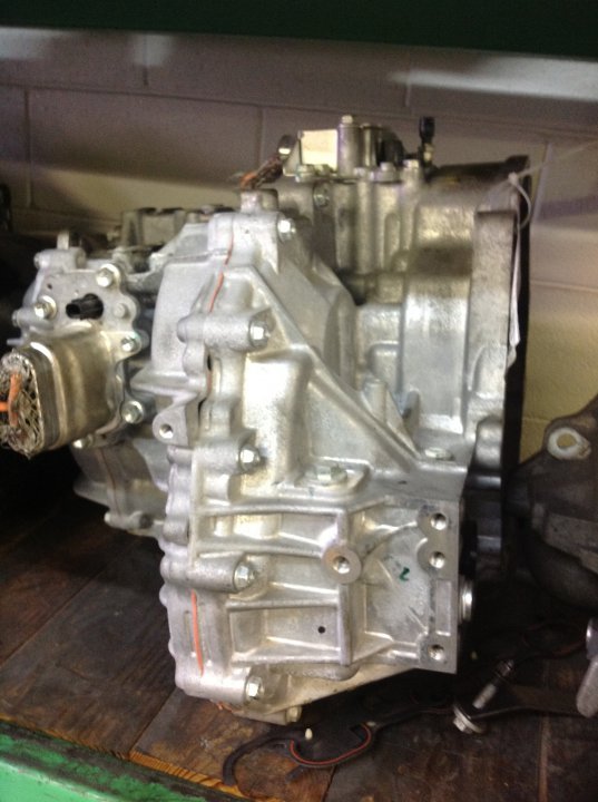

    From time to time in various threads this question has come up: does the Prius have a transmission? Various people have asserted that it does not. After all, it doesn't have a traditional hydraulic torque converter or clutches that engage and disengage gears.
    As far as I can tell, there is no consistent, widely agreed upon, and precise modern definition of the term 'transmission'. Correction -- it's likely that there is a precise SAE definition of the word 'transmission' in the J645_200903 standard but it's hidden behind a paywall and I'm not going to pay $70 for a 3-4 page official glossary....
    However, there is the Duck Test:
    Prius:
    Volt:
    Additionally, the first U.S. patent that closely describes the Prius HSD refers to that device as a transmission: "ONE-MODE,INPUT-SPLIT,PARALLEL, HYBRID TRANSMISSION".
    Specifically, see column 11 on the PDF document page 19 with the sub-header "Description of a third alternative embodiment" for the HSD variation:
    http://www.google.com/patents/US5558595.pdf
    The later Toyota HSD patents all reference this 1995 GM patent filing as prior art.
    The even earlier TRW patent filed in 1969 (US 3566717) foreshadows the HSD design and also contains no clutches, mechanically shifted gears, or torque converter but differs in some ways. It also describes such a device as a transmission:
    In any case, Toyota regularly refers to the Prius 'transaxle' in their manuals and technical documents. A transaxle is widely and consistently defined as the combination of a transmission and a differential inside the same casing. Transaxles are used in front wheel drive cars in place of a separate transmission being linked with a rear differential.

    I have read that both of those transaxles pictured above are made by the same supplier for Toyota and GM.
    However, a decade of technology separates them.
