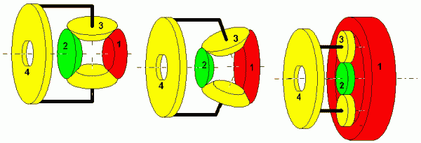

    This picture illustrates the evolution of the old common limited-slip rear-axle differential into the new planetary-CVT concept similar to what's used in the eCVT:
    • source: Understanding Planetary Gears

    Correct, Toyota's innovation was NOT mechanical, but adding and consuming power at all of points 1, 2, and 4 in the rightmost diagram. Previous Planetary gearset usage had one or more of the points 1,2,3,4 fixed, and only flowed power though a singe input and out a single output. In the old LSD, all engine power enters in 4 and exits via 1 and 2.

    As was once said, "...it's like holding onto an Octopus: it depends upon which legs you ARE holding and which ones your AREN'T holding." (wink,wink)
