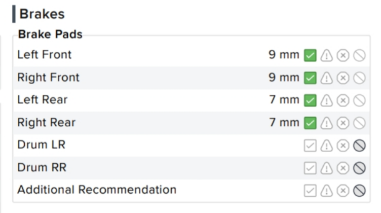

    What I do when going downhill is I turn on the AC. I've being doing this for a year now because of lots of downhill driving.
    My brake pads are from the last 95k check by dealer.
    How will you know how AC braking vs normal braking feels? Just try it out yourself. Find a safe place to test the brakes under normal mode. Then do the same under AC mode. Then do the same under EV and AC mode. Then try EV, PWR and AC mode. See how efficiently the car brakes under different setting. The goal is to drain excess electricity so that some energy is left to be used to brake the car using regen. Try to do this when battery bars are full to really know how efficient AC mode can be. You don't need to use AC everyday only when long downhill braking is needed and bars are at full.
