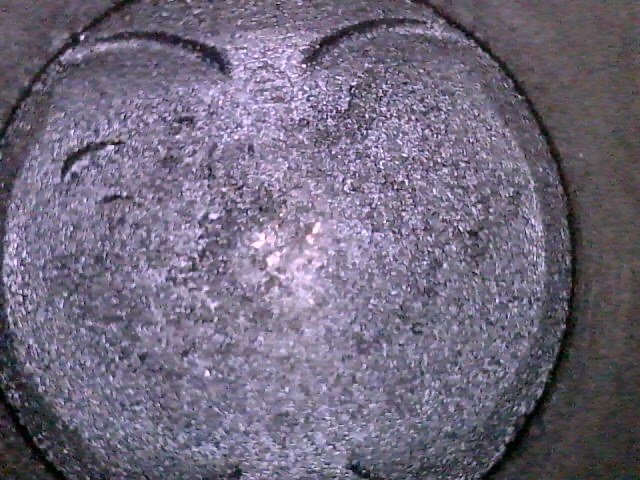

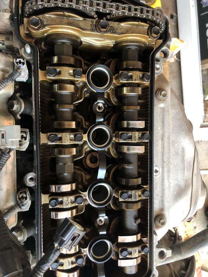

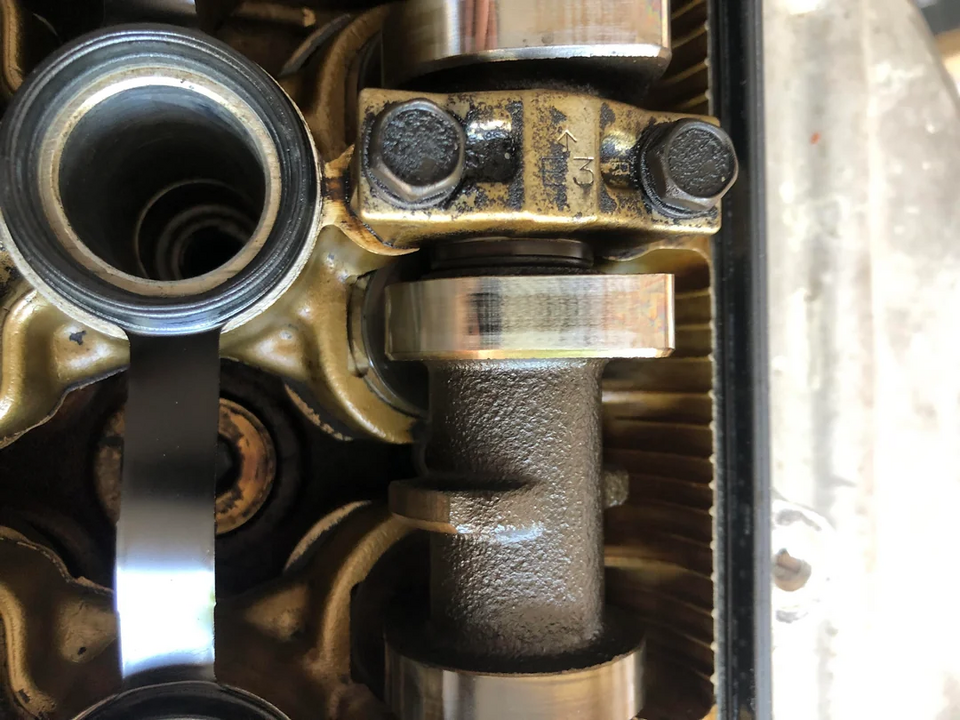

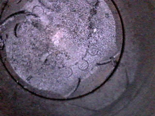

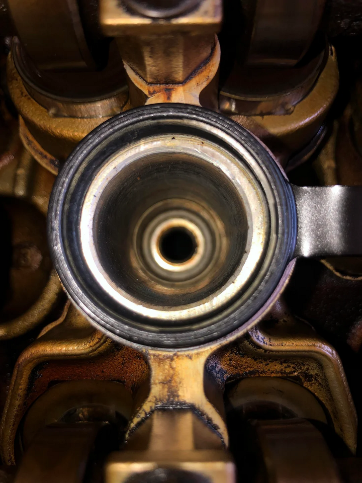

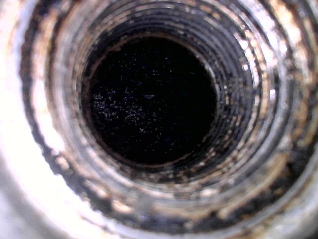

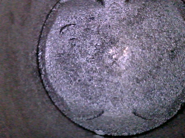

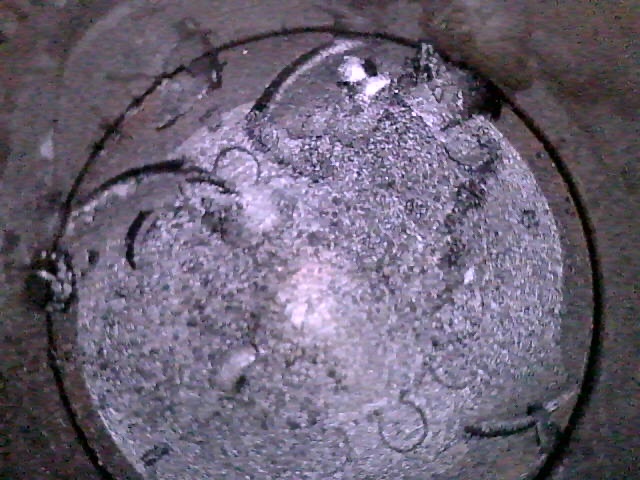

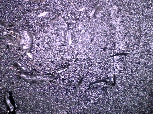

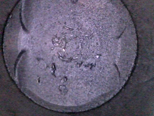

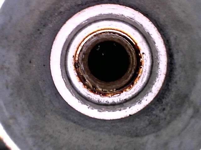

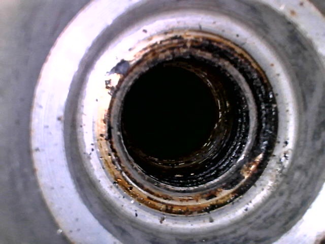

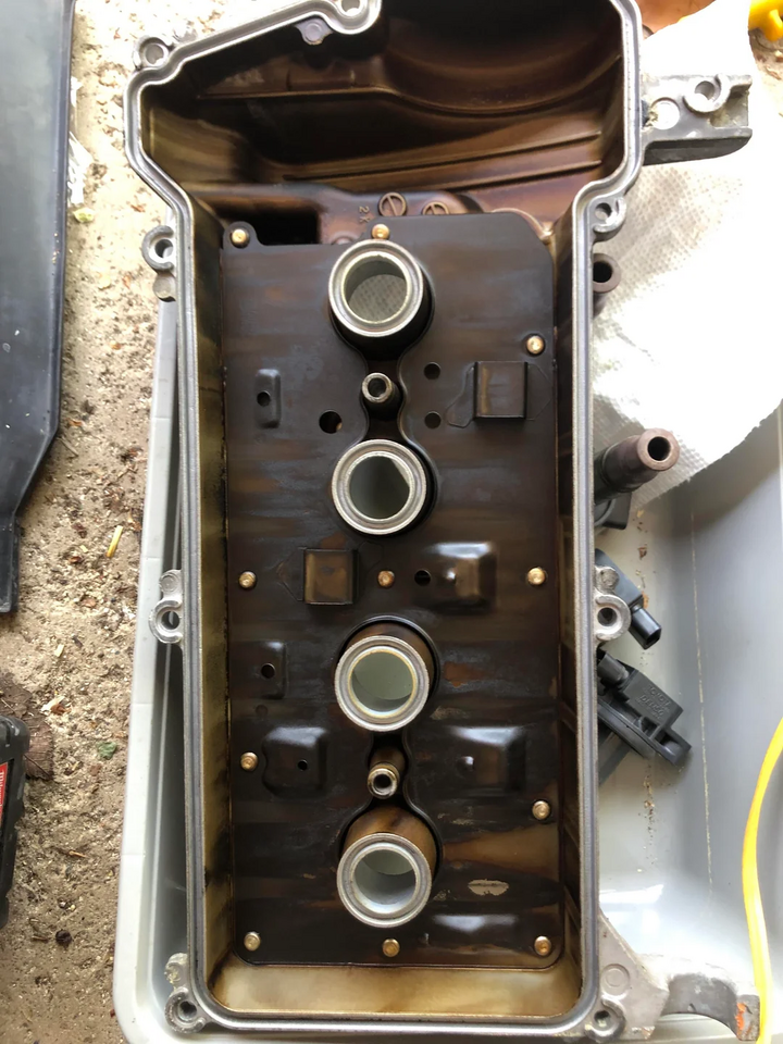

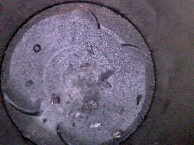

    Just bought this second gen Prius powertrain that was purported to have under 60k miles. My initial inspection raised some doubts but I want to know what you guys think of my findings.
    Cylinder 1
    Cylinder 2
    Cylinder 3
    Cylinder 4
    #1 Pd30242, May 8, 2025

    Personally I would say probably not looks more like about 90k possibly higher but you'll never make that stick I would say you did better than you would do in the states everything you'll find here has 300K on it or close to it or you won't be able to get the engine out of the 130,000 mile one because the whole car is still for sale for $8,000 or better so not sure how this is going to help you or not to be honest with you that actually looks more used and dirty than my $197,000 MI 13 persona when it broke and I have pictures of that whole engine tear down right here but this is an early version of this type of design engine so it looks like my early 4AGE internal and stuff like that.

    The spark plugs look like the engine was burning a lot of oil. If the engine only had 60k miles, the spark plugs would look like they were almost new.
    Where did you buy the engine from?

    Mount the vk16 spark plugs too

    The cylinder heads being absolutely caked in carbon make me think this thing burns oil too. I got it from JDM Alliance on eBay. They have great feedback and I have contacted them to see if I can get the engine exchanged for a different one. Waiting on their response.

    Those were some hard miles! The plugs look like crap, bet the motor burned oil. Which makes me think the oil was not changed often enough. Bores show crosshatch, but I have seen hatch on 200K mile motors. If there was enough oil in it to send a sample to the lab for analysis the data would be very interesting.

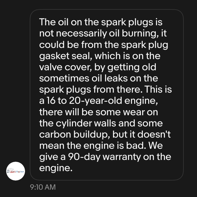

    UPDATE - I raised my concerns with the eBay seller and this is what he had to say:

    I do not buy the sellers idea that a gasket leak is responsible for oil on the spark plugs because all 4 spark plugs are the same.
    What is the color of the injectors on the JDM engine? I remember reading the color of the injectors on a JDM engine is different than the color of the injectors on a North American engine.

    If this engine has only 60 thousand, then the oil poured from the factory has never been changed. The color of the engine's insides is covered with a thick layer of varnish. Varnish deposits should also be on the piston rings. There are not even rings, but most likely everything is simply glued together with a thick layer of varnish carbon and the consumption of oil flying out into the pipe is simply hellish.

    I have to agree the spark plugs look worse than some I have seen at 120k miles. However the top of the pistons look decent.
    I suspect JDM gen2s are getting rare since they are all 16-21 years old. The story JDM sellers repeat is they are 60k miles or less because the Japanese government forces them out of service.
    Is this engine actually a JDM or simply a salvage yard US engine? That has happened before and sellers in Texas are allowed to do just about anything.
    On gen3s there are a couple clear indicators of a JDM engine. The injectors are tan and the model label is X2ZR-W20 instead of the US engine's
    X2ZR-W25N. US gen3 engines usually have a vin label on the back that JDMs do not have.
    With that said I do not know if any of the differences apply to Gen2s. You could compare your oem vs the "JDM". If you can prove it's not a JDM ebay may refund you. Otherwise you might have to install it and see how it runs before your 90 day window expires.
