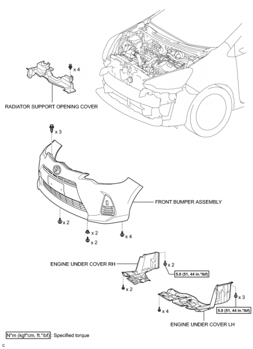

  6. olieman
    olieman Junior Member
    Oct 24, 2014
    Netherlands
    When you look under your car you should see some underbody covers.
    See the detail below.
    robertmaria likes this.
  7. robertmaria
    robertmaria Member
    Mar 28, 2014
    202
    please DELETE this account
    2014 Prius c
    wow, you guys get REAL METAL bolts too !!! ,,, my car in america is held together with PLASTIC PINS !!!
