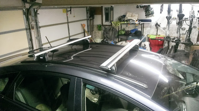

    Also had the folks at Rack Attack install a roof rack capable of 165 lbs, which is the rating of the roof according to european specificications.
