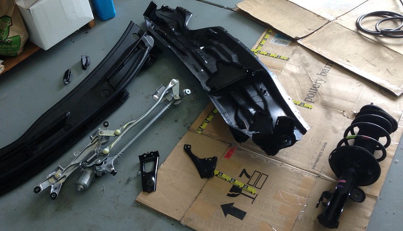

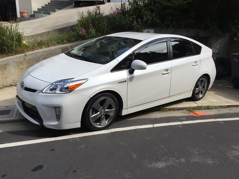

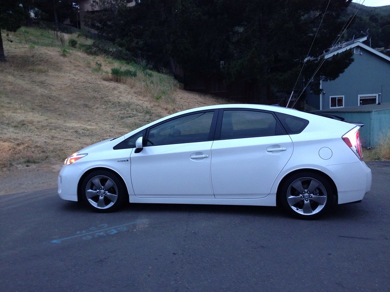

    Just installed my Plus springs. Install went pretty smooth with assist of PC thread's. Thanks to the forum members that shared their details. I took about 4 hours and that's due to forgetting to put back the bump stock on one side. Most of the time was to remove the covers to get to the front towers.
    Love the look but not certain on the ride.
    A few details to add;
    1. Have a 1/2" breaker bar and long cheater bar. The lower strut bolts are the def. torque down to 250ft. lbs!
    2. Having a impact gun helps tremendously. I used my small 3/8" 18V makita.
    2. Spring compressor not mandatory if you're experienced. Unloading without compressor only with an impact gun. Plus springs are short enough without compressor.
    Here's a before and after.
    Before;
    After;

    Some feedback after my first commute;
    A lot of the float is gone compared to stock springs. IMHO, if you cruise on freeway a lot, going with Plus springs isn't a tough decision. If you drive in the city a lot with bad roads, it maybe a concern. Overall you feel the undulation of the road more.

    Here are the parts that needs to be removed to install springs to give you an idea of work involved.

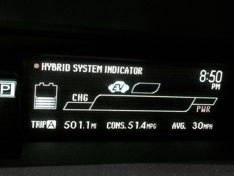

    I haven't updated this for a little while.. since, I've made the 500 miles per tank.. 2x's. Installed window visors and that's about it. The car has 0 issues. MPG has been going up but I think that's due to technique and weather(warmer).
    500 miles tank and got a best 48 mpg.

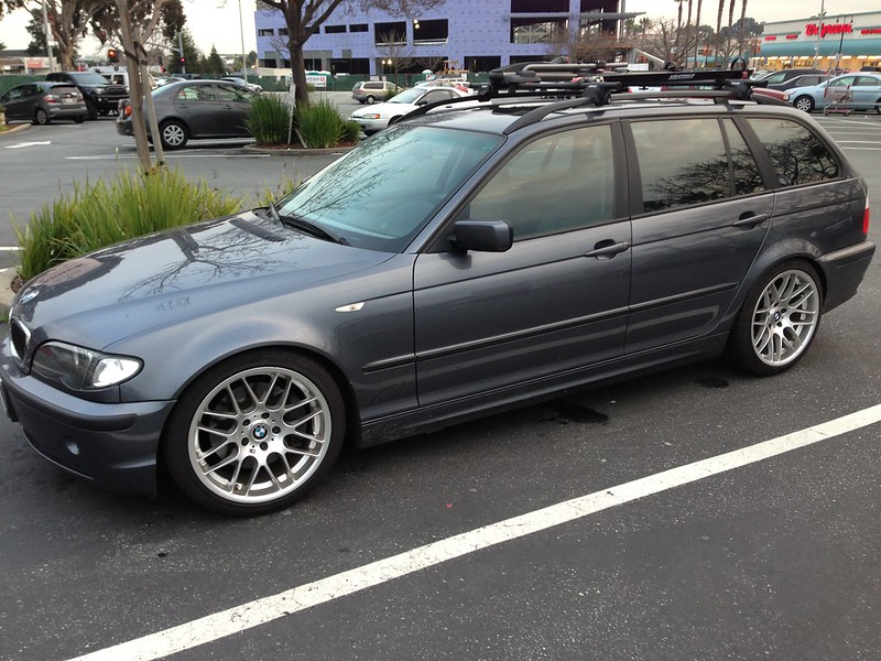

    The Prius deserves some attention... been neglected since I got the 911. Washed and waxed!
    It's been a great car and trouble free to no surrpise. The Toyo A20 seems to already near end of it's life. I'm at just over 40k miles and I think maybe another 6k miles max?

    top car is gorgeous!:p
  19. socal13
    socal13 livin in the foothills...
    Feb 28, 2013
    267
    Altadena CA
    it's a beauty! I'm going to get mine waxed (car that is)!!

    Each is beautiful in it's own way.. clearly you're biased..
