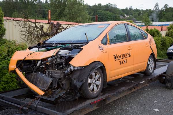

  16. Mendel Leisk
    61,575
    42,364
    I don't quite understand, how Prius slowing by B-mode is going to get front end damage, lol.
    Likely the reasons for front end damage are:
    1. The spectacular front end crumple zone.
    2. Cabbies.
