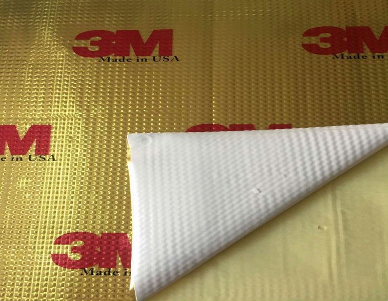

    do not know. What's behind that 3M gold layer?
  14. abubin
    abubin Member
    Dec 7, 2019
    193
    92
    Malaysia
    Another layer of 3M gold.
