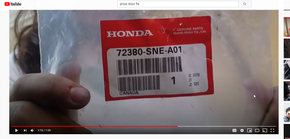

    hope this will be a good /affordable DIY fix for Drivers door on my 05 that keeps closing on my leg.
    The part in question is apparently called "door check" (see Video for explaination)
    Toyota wants $80
    Honda Part $20 (see attached for part # specific to drivers side only)
    Waiting for part to arrive.... I'll report back after the install with outcome!

    Please check the length. Or how much it allows the door to open. If it's slightly shorter the door won't open as much which isn't a big deal but if it's loner the door will open too much and can cause real problems.

    ..Good News.....$20 Honda part fits !!
    Hardest bit process was turning it just right to get thru the small access hole in the door panel.
    This part # below is specifically for the Drivers Door.

    Since you installed it already you could check how far the door opens if the stock one is still on the passenger door you can compare the opening to it. Should be pretty easy measure distance from stricter to latch on fully opened door.
    Getting the part in and out is very easy after you've done it couple of times. I took them all out and in just to make dent on them to get them a bit tighter.
