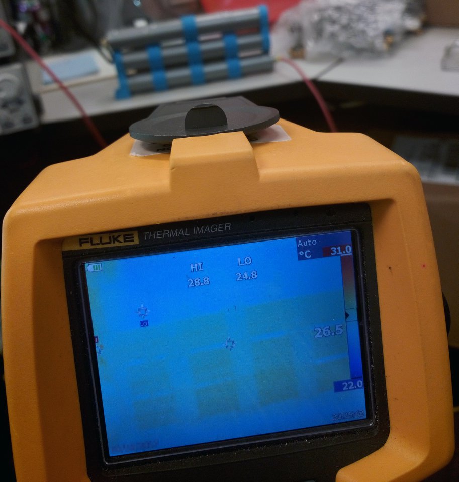

    Was under the impression the prismatics were harder to cool, or is it only the modules sandwiched in the middle of a pack.
    Aren't there air gaps around the cylindrical cells (in @2k1Toaster retrofit) that would allow for better overall air flow?
    I generally run the HV fan at the '6' setting in an effort to keep the stock HV battery temps low, what might be the preferred operating temperature for the OEM HV battery?
    Curious if anyone has taken an IR gun and measured battery temps for the Prius, Honda Insight or @2k1Toaster 's product

    I believe @2k1Toaster has run temperature tests. I remember some images.
    From Prius Battery Replacement Kit (GenII/GenIII) with NEW custom cells | Page 3 | PriusChat
    Raytheeagle and SFO like this.
