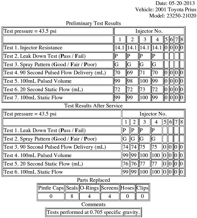

    For David (and all) ...
    While reading through this thread, here's a thought I had:
    Every time I send, say, fuel injectors to Rich Jensen for reconditioning, I don't just get the fuel injectors back. I get them back with the measured details of their condition, keyed to serial numbers:
    That's pretty nice for giving me confidence in what I'm getting, and for interest as a baseline reference to their future condition, and so on. Really, there are a lot of reasons that's nice.
    I'm sure that in your operation at Dorman, you've got a database, probably by serial numbers, of the modules in your inventory, and the Ah capacity they last tested at and what date that was, and which ones were assembled into which battery you shipped. I mean, I don't even feel like I'm going out on much of a limb by assuming that you've got that information.
    So, I'm curious, because I've never bought one from you yet: does Dorman take the time to print that information off on a nice little sheet and slip it in the box? If not, would it be hard to do?
    I'm assuming (perhaps incorrectly) that nothing like that comes with Toyota's batteries. I would consider it a valuable distinction in favor of your product. It's easy to fill a forum thread with high-level opinions on whether new or reman should be the better way to go, but if I can ask the question "which option gives me a battery that comes with hard test data and dates for the modules built into it" and the answer to that question is "Dorman's", that could definitely influence my buying decision.
    A related question (that maybe is answered in your FAQ, but I haven't looked for it): if the spec capacity for a new battery is supposed to be, say, 6.5 Ah, is there any particular minimum capacity (as of some test date prior to shipment, of course) that Dorman commits to?
    -Chap
