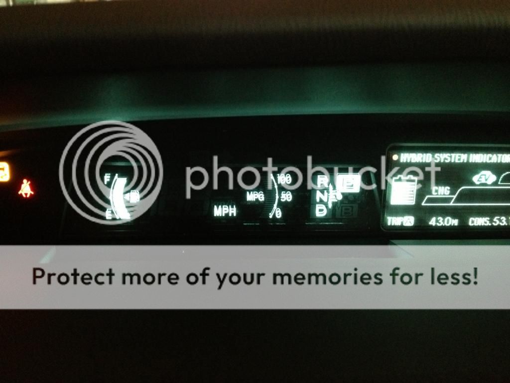

    I just took delivery of a 2013 Package 3 and my display is awful. It hurts my eyes and I am very very unhappy. This should not be like this. :( When I test drove I did notice the display but I had polarized sunglasses on and it made it look better.[​IMG]

    It's a refraction caused by the thickness of the mirror glass at the 45 o angle. Wow ! Picky, picky, picky.

    I have this problem on my month-old car and it is very annoying. I think I will take it to a Service Center or to the dealer and see what they say.

    First, I'd recommend cleaning the glass with a simple solution of white vinegar, hot water and a small shot of hand soap for doing dishes in the sink (it's what pros use to clean car glass without streaks).
    If that doesn't help, something is wrong with the glass.
    I've noticed what seems to be what you're talking about from time-to-time, but it's not there 99.9% of the time, so I think it can be the product of environmental factors in addition to the glass itself.
    It is present at various seating heights? Maybe at a different viewing angle it disappears.

    It does vary in severity depending on the angle and distance, however it never disappears.
    Also, it is significantly more pronounced at night when the headlights are on.

    I understood that this was a well known problem when the windscreen was replaced by a non-OEM screen.
    A number of drivers have been back to their insurers and insisted on the correct screen being fitted because of this and the insurers have complied.

    I went to the dealership and they told me this was the case on all models and nothing could be done. They showed me the other Priuses in the lot and they were the same.
