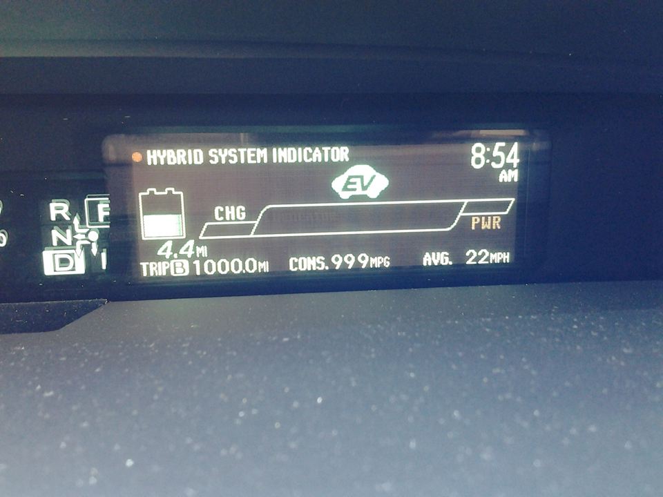

    Hello been a while since i posted just wanted to keep the board updated with my milage. The question to rob was about the prius battery and cycles If i cycle it 2 to 3 times a day if my expected life of car is 10-12 years isnt that 10950 cycles for 10 years? even at 10 miles per cycle thats just still under the 150k warrenty on the batteries correct? my question is how is toyota getting this kind of service duty outa li-ion./? first 1000 of may i hope.jpg

    wow....now you are someone who uses EV ONLY ALOT!!! nice MPG!!!
    Is that entire 1000 miles ALL EV??? or do you have some HV miles in there too but still max to 999? Very cool

    so did i get the door prize for ev millage?

    ev king!:D
