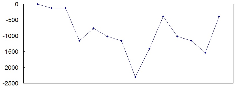

    I took ADS-B data from the ‘professional pilots’ rumors‘ website discussions page. It looks like this:
    LATLONG HDG (magnetic) UTC ALTGS(ground speed in knots) VAS(vertical air speed in feet/MINUTE)
    37.7286 -122.4901 139 6:14:56 PM 11125 256 0
    37.6863 -122.4439 139 6:15:50 PM 11100 254 -128
    37.6219 -122.3773 144 6:16:54 PM 11100 253 -128
    37.5626 -122.3368 152 6:17:52 PM 10225 250 -1152
    37.501 -122.2965 152 6:18:52 PM 9150 248 -768
    37.4398 -122.2477 120 6:19:56 PM 8800 250 -1024
    37.4136 -122.1699 112 6:20:54 PM 7800 249 -1152
    37.4211 -122.0942 44 6:21:52 PM 6225 244 -2304
    37.4816 -122.0775 327 6:22:54 PM 5050 241 -1408
    37.52 -122.1406 297 6:23:52 PM 4275 219 -384
    37.5477 -122.2064 297 6:24:54 PM 3400 202 -1024
    37.5726 -122.2652 297 6:25:54 PM 2175 186 -1152
    37.5954 -122.319 297 6:26:54 PM 1100 149 -1536
    37.6123 -122.3595 297 6:27:54 PM 75 113 -384
    Those are data with 1-minute resolution. I have not yet converted the lat/long into distance out from threshold, but I want to draw you attention to the final data column, vertical air speed. On a graph it looks like this:
    There were 3 pitch/VAS cycles during the final 10 minutes of this flight. To any of you that fly, this WILL NOT indicate a stabilized approach.
    However long it takes the engines on the Boeing 777 to drag you out to a missed approach, it was THEN that the pilots should have called it. From FDR audio we now understand that the missed approach call was made at -1.5 seconds, and engine spooling at -8 seconds. Not soon enough.

    Forgot to mention that I made a serious error in my first post here. Vertical airspeed is in feet per minute, not feet per second. In fact I'm going to edit that into oblivion right now.
