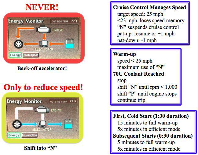

    A work in progress, this is how I'm doing a 'stunt' drive in our NHW11, 2003 Prius:
    These are the rules I'm following in my latest driving stunt . . . to achieve maximum range in our 2003 Prius . . . and keep my job. Traditional stunts in North America have been done as single, butt-busting efforts often requiring more than one driver over multiple days. But by managing warm-up costs, one can spread such efforts over several weeks and in the end, achieve 90% of the non-stop, endurance drives.
    The goals:
    • minimize warm-up cost - this is the least efficient Prius mode so burn as little gas as possible as there will be at least two per day
    • dilute warm-up cost by a 5x efficient, trip extension - for every trip during the stunt
    • minimize drag - run the car at the lowest, practical Prius speed on cruise control and found on North American, urban roads, 25 mph
    • minimize traction battery charging from kinetic energy - transfer efficiency between kinetic-potential energy is 100% but round-trip traction battery transfer is less efficient
    Objectives:
    1. Have a loop near destinations where you can do the 5x trip extension. It should be mostly free from stops and traffic.
    2. Choose routes with two lanes in direction of travel so following traffic can easily pass.
    3. Choose routes less traveled to avoid other traffic.
    4. Shift travel times between midnight and dawn or other non-busy periods.
    5. It is terribly boring!
    6. Obey traffic rules as they are 'noise' in achieving the driving stunt objective, maximum duration.
    Instrumentation (optional):
    1. Engine coolant reader
    2. Engine rpm reader
