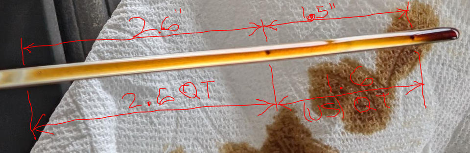

    I came back, let the car rest then checked the dipstick here is the pic: [​IMG]
    I drained the oil from the main tank - it filled (1) 5qt jug, almost (3) 2qt jugs (so about 11qts of oil came out)

  13. Mendel Leisk
    61,506
    42,323
    Just doing a bit of extrapolation, looks like (very) roughly 2.6 (US) quart overfill:

  16. Mendel Leisk
    61,506
    42,323
    Just going by the dipstick pic, and assuming nothing's been drained and it's a good reading, on level ground: If oil was at dipstick top mark he'd theoretically drain 4.5 US quarts. That dipstick is indicating roughly 2.5 quart overfill, so say 7 quarts drain.
    Whatever, it is gross overfill.

    I think the dipstick is not intended for a 7 qt overfill. Obviously there is more room in the upper oil pan than in the calibrated lower section.
