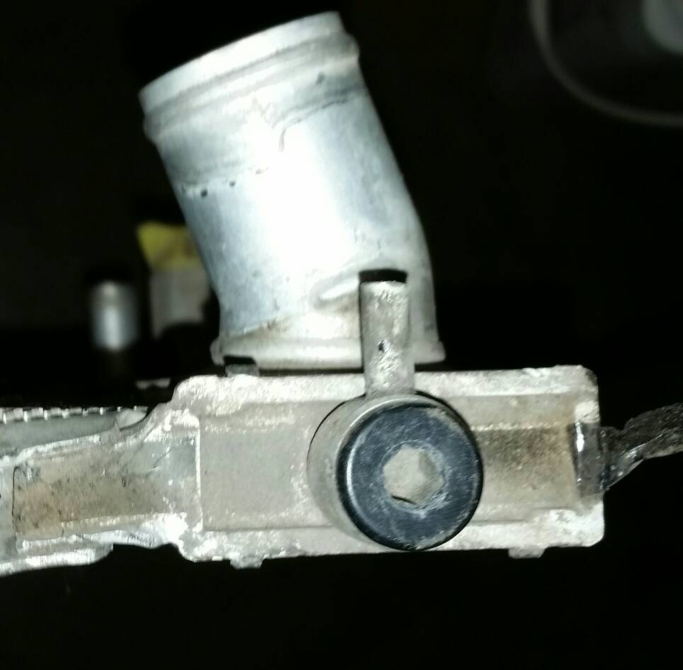

    The bleeder valve for the engine coolant system is on the top of the radiator. It needs a 6 mm hex key to open. Look for an access hole after you've removed the large black plastic panel over the radiator.
    The purpose of the engine coolant valve is to route coolant either to the cabin heater core or to the coolant heat recovery system canister.
  2. specialtyneed
    specialtyneed Junior Member
    Aug 31, 2015
    75
    16
    Central US
    This is it on drivers side but under the core support upper plate.

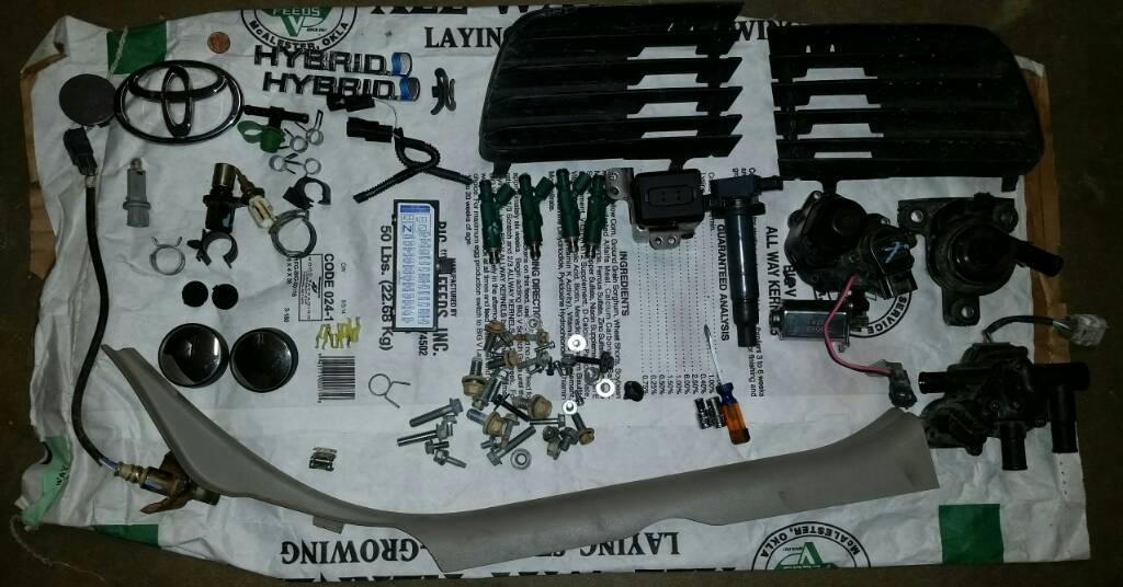

    Pulled a treasure trove of parts mostly off an '07 from salvage for $ 98.xx.for missing ones for the '06 & troubleshooting and keeping both our Gen 2's in good order. We also found 3 small hand tools near lower RH:
    The sensor that is magnetic under the toyota hood emblem with black connector is the one for cyl head above the larger upper radiator hose.
    Got that always valuable handfull of metric hardware.to boot.
    Forgot to include a wheel trim ring also. Getting another tomorrow along with a couple more parts.

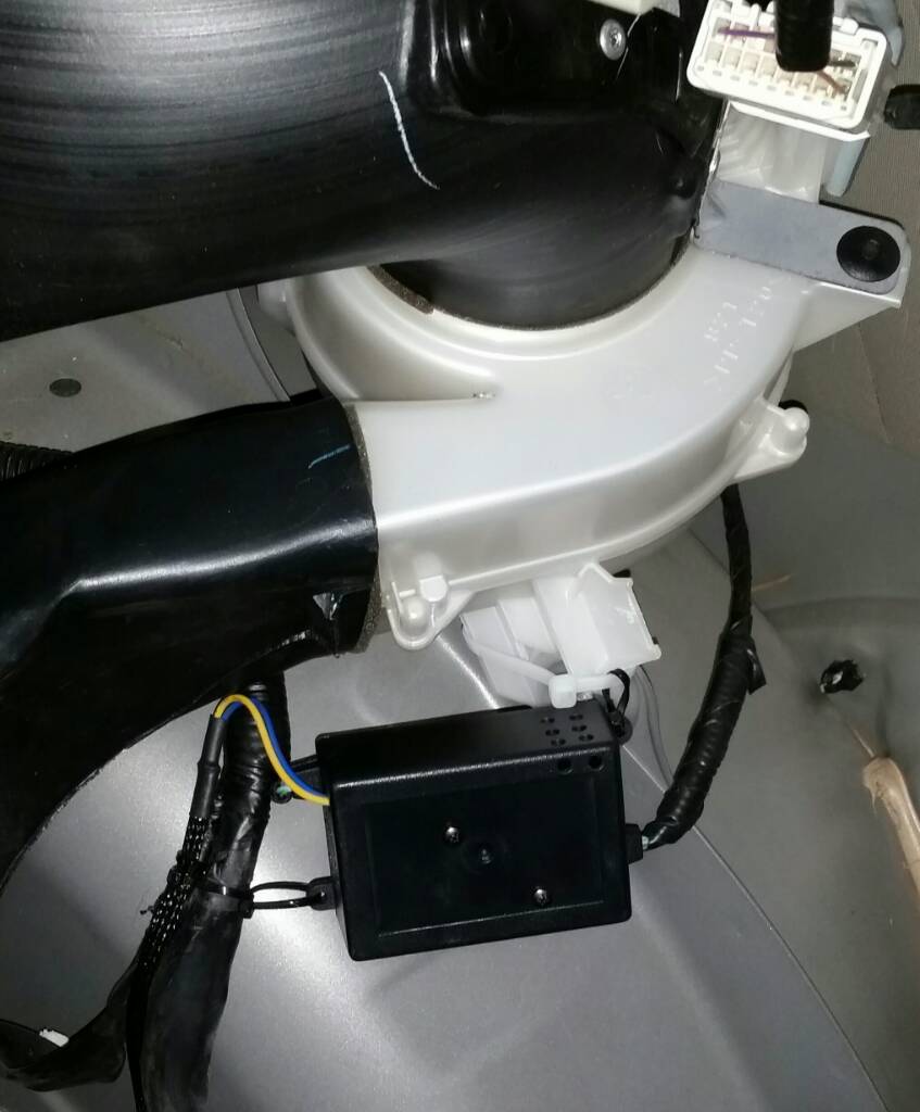

    Hybridautomotive.com Prolong "Grid" charger, fan control installed & working normally:
    Drove her a nice drive with heater on to get rid of our suspect air in cyl head @ sensor for fans over 80 mph (while monitoring temp & other things with Torque Pro) after 24 hours on the Grid Prolong charger no dummy lights for 4 miles then expected brakes, VSC ((!)), (we reset yellow brakes dummy lights using OBD 2 port paper clip [​IMG]
    before 2nd drive tonight) check engine came on, again as expected with these persistient P3014 & P0A80 ref in quote above. Fans are not running all the time after warm up any more and are normal operation cycling ocassionally very brielfy on. Added a pint of coolant as expected. My HV batt fan is cycling normally also. HV batt is acting, charging more normal now.
    Our VCI Mini came in but our PC is out getting Win 7 on it by a generous friend.
    We will order a pair of modules friday for block 4 (still not sure how the blocks are numbered) if it is not happier after another 20 hours for the 2nd part of the cyce on the HV Prolong Grid charger. Finally found the discharge option on the newer pinkish titled pages in the menu for the installation instructions & user guide as the PriusChat Store older site options were not user friendly and did not list the two bulb discharger. Am trying via email to order another discharge ready wiring harness for our '04 & the 2 bulb discharger.
    Getting excited as she is title ready for monday.
    Need a tire pressure sensor as one is not happy but will get to that as I play with them more or swap one at a time with the '04.
    We did have a brief but disconcerting episode with the HV Grid Prolong charger fan relay control today. My young adult son was plugging it back in to our 10ga extension cord after moving her down off ramps from the install of salvaged drip shields / cooling shrouds in & below the front and sides and after interior cargo area panel reinstall when he says the fan relay control was making a lot of noise (asked for a video but it quit) and the HV fan was cyclying quickly between high & low speeds. He unplugged the charger and pulled the panel and inspected things but was miffed when plugging her back in that it acted normally. We removed the block of foam for better airflow like the instructions stated. A few hours later still normal for this stage @ 242v & 351ma.
