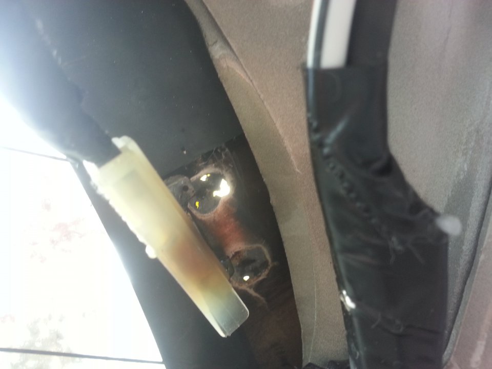

    I have to ask about the heated rear window - I drove for over half an hour the other day with the defroster on and it only cleared the bottom portion of the rear window. I don't think I've ever had any noticeable affect from the defroster on the upper portion of the rear window. Is this normal (i.e. does the Prius defroster just suck), or should I be trying to troubleshoot?

    Yes it should heat upper and lower section. And (I think) it should eventually turn off by itself. I would first fix heating of upper rear window and then check that it turns off automatically.

    Damage to the heating elements, maybe?

    I'll be checking them tomorrow. Hopefully it will stay warm enough (50+) to do a repair if needed. No garage available.

    Found the problem. Pictured is the connection for the upper window.

    On the bright side, that can easily be fixed.

    I'd heard that before and figured it was probably the issue - but I finally got fed up and checked. I went over every line of the elements carefully and was surprised to find no breaks. Almost gave up but decided to check the connections, and found the break.
    I've ordered a kit with adhesive that got decent reviews for this type of repair. Everyone says the key is to follow the prep instructions well. I'll update this weekend when it should be warm enough for the adhesive to work.
