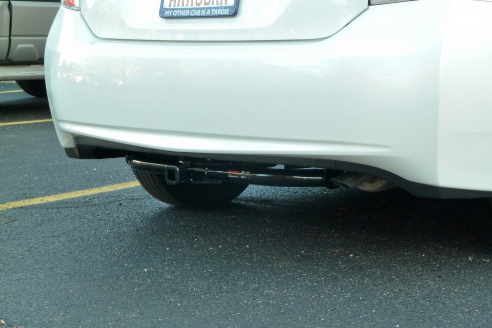

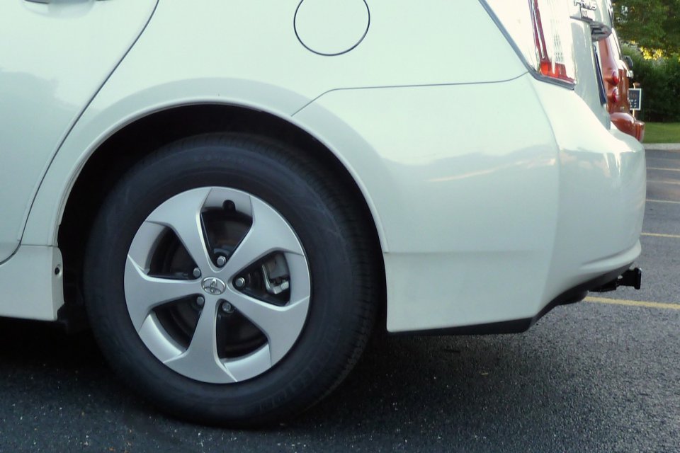

    I'm a new Toyota owner just having purchased a 2014 Prius Two on Memorial Day. Yesterday I had a Curt hitch installed, which I selected because it require nothing to be cut and I do not find it to be obtrusive in its visibility at all. I liked that the under tray and rear body work required no modifications to mount. Only using it for a bike rack. 2014-06-03_P1010204.jpg 2014-06-03_P1010199.jpg

    Looks good. I guess I probably could have got the hitch on without trimming the underbody, but I didn't even have the car jacked up.
