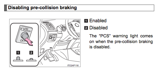

    Does anyone know "how" the PCS system works? I read the manual and thought when the dealership turned it off, that meant the system was no longer active. It should not continue to see "ghost" objects ... it's suppose to be off.
    I was driving yesterday and the seat belts suddenly retracted, HARD. I was going 30 mph and there was nothing in front of me. I was unable to reach anyone at the dealership but left a message asking why that would happen if the PCS was suppose to be off. I believe my system is defective.

    The dealer showed you where the PCS button (labeled PRE-CRASH) is. When you push it, the PCS warning light comes on. I don't think they actually turned it off.
    You should really read the manual and educate yourself on this if it's going to go into arbitration. You sound as clueless as the dealer and that doesn't reflect well on you.

    32kcolors, does your Prius have the PCS? If so, have you read "your" manual? I read mine and there is nothing defining what to expect when you "turn it off". I'm not an idiot and the definition of OFF is to have something no longer connected. The letters PCS are lit on the dash and per the manual, indicates it "is" off. The question I was asking, or needed clarification, was if "anyone else" with a PCS understood the manual as I did ... that PCS lit on the dash should indicate the system is disengaged and should no longer sound bells, retract the seat belts or slam on the brakes.

    That doesn't mean he's wrong. If you've read the manual thoroughly, you would know that the PCS-OFF button only disables the Pre-Collision Braking. Pre-Collision Seatbelts and Pre-Collision Brake Assist will continue to function. And yes, "Pre-Collision Braking" is mentioned twice.

    I don't know about the 2013 manual, but the 2010 manual is pretty clear on this. When it's disabled, "PCS" is displayed in the dash. Retracting the seat belt when you slam hard is a normal function of any modern cars and not indicative of PCS in operation. What PCS does is tighten/pull it further in addition to retracting it and feels just like your kid behind you tugging on your seat belt.
