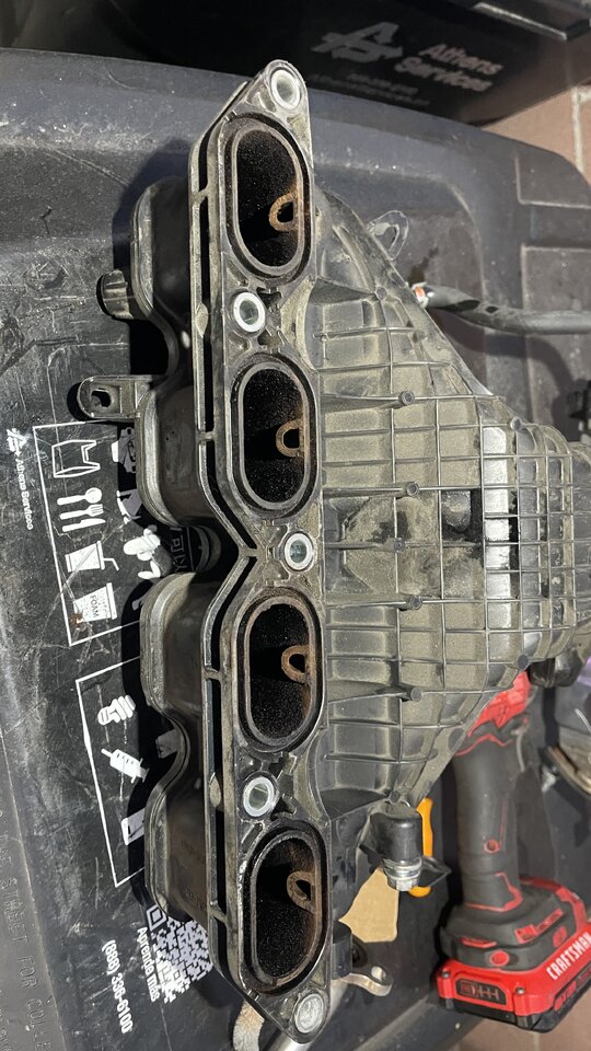

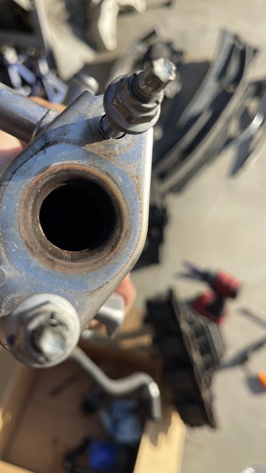

    Update:

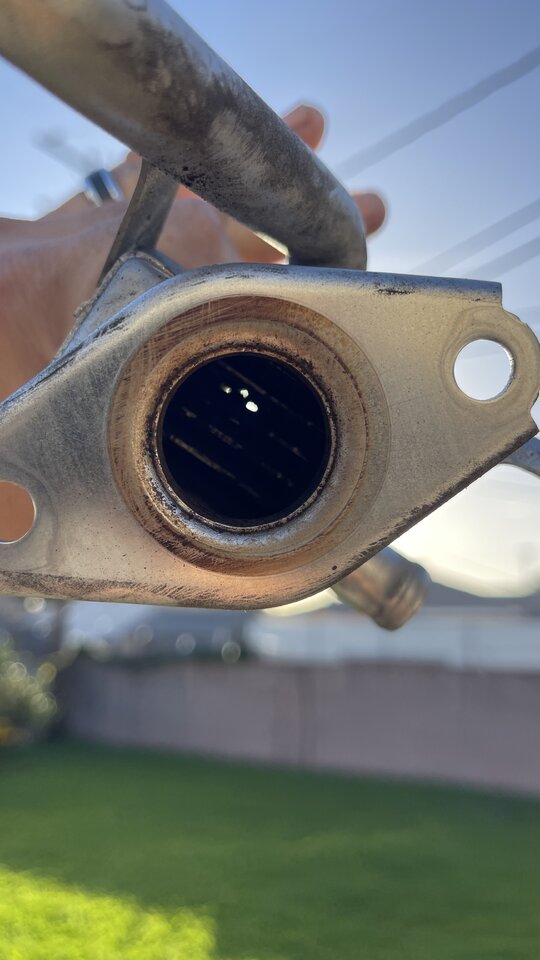

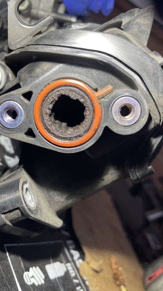

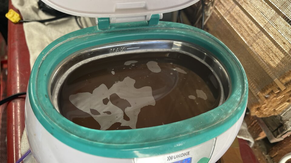

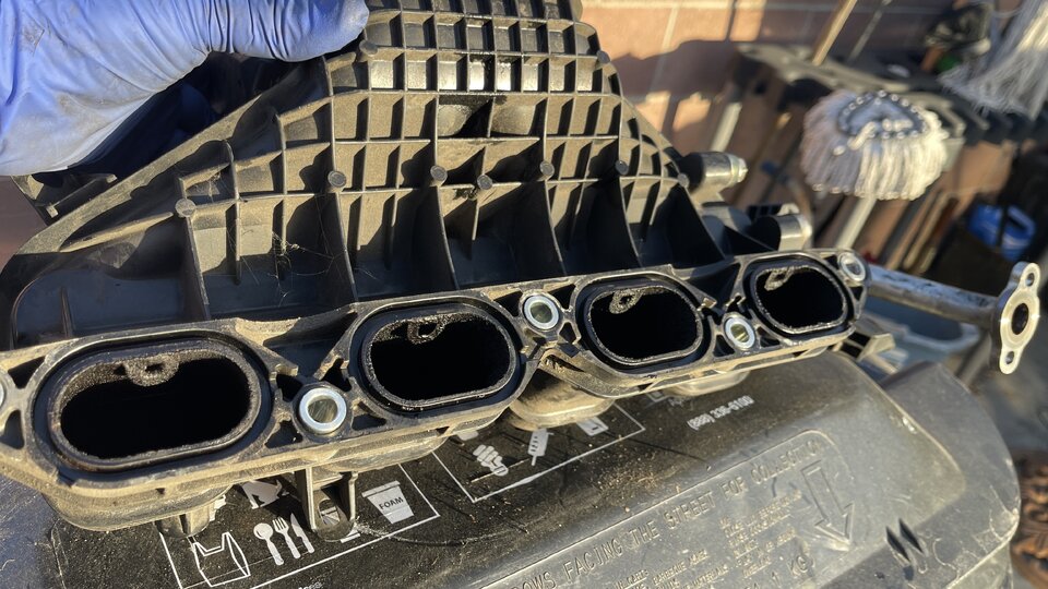

    I removed the EGR, cooler and Intake Manifold to check out their condition and they were gunked up. The small hole port inside the intake manifold on cylinder 1 was completely blocked and had hardened crust which I had to loosen with a pick and then clean with a wire brush thru. The EGR was dirty but not too bad, the PCV was also ok, the cooler was a bit gunked up as well where I couldbarely see traces of light thru the other end. I put it all in an ultrasonic cleaner and will check in the morning how they turned out.
    I am also thinking of doing an injector cleaning and was wondering if there is any specific method to removing them. Like remove a fuse to release pressure or something like that? Also, could I soak those in a ultrasonic bath as well or just do the cleaning the 12v connection and carb cleaner way?
    Here are some photos of the gunked up parts and partial clean up before the ultrasonic bath.

    The cooler is really blocked. The intake manifold is really bad.
    PCV valve is $10, BEST to replace it, as bad as the blockage is. Just because you can shake it and
    it makes noise means it good.
    How BIG is your ultrasonic cleaner tank??? How many days will it take to clean each part?

    Yeah it was bad, which in a weird way I am glad i found it this way as it could very well be the cause of the p0219A. The PCV was ok and makes noise when shaken but still opted for a new oem PCV. My Ultrasonic cleaner is 15L which fit the cooler, piping and EGR and still had room for more. I did 4 separate 30 min sessions at 120F (50C) and all the parts were left like new after the 3rd time, the 4th is just for good measure.
    As for the injectors, I have a small 2L jewelry cleaning Ultrasonic which I have cleaned all other injectors in and will do so with that and the small injector pulse machine to run current thru it while spraying cleaner into it. I just did not know if you are to relieve pressure on these priuses like other cars before removing the injectors. And if so, what is the process since these engines start then kill off after a few sec’s.

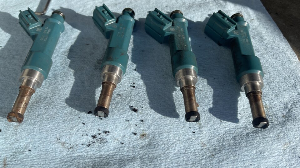

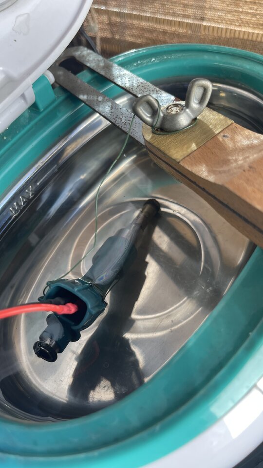

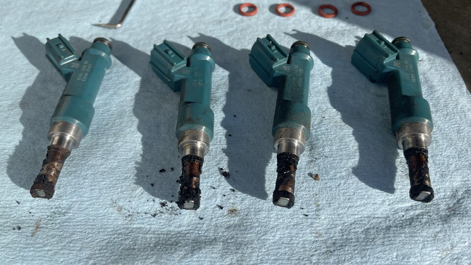

    Here are some photos of the ultrasonic cleaner I have used for the injectors, the injectors before and after the bath and the pulse machine to test injectors as well as pulse them while in the bath
    Before:
    After:
    IMG_3504.jpg IMG_3509.jpg IMG_3507.jpg IMG_3500.jpg IMG_3506.jpg IMG_3510.jpg IMG_3505.jpg

    The OUTSIDE looks okay. Wonder what the inside looks like?
    Did you test spray them before the bath to see the pattern? Then afterward to see if it changed?
    Attach a hose to the output side, and to the nozzle of the carb cleaner then spray, creating pressure,
    and open and close the injector so you can clean the most important part...

    What is the liquid in the ultrasonic cleaner? And what do you mean by pulsing? How does the injector tester work?
  16. ChapmanF
    28,751
    19,056
    In the car, the injector gets electrical power in small pulses, say 1 to 3 milliseconds on out of every 100 milliseconds at idle. An injector tester allows you to power it the same way out of the car.
    PriuSocal likes this.
  17. indel
    indel Member
    Apr 1, 2024
    283
    89
    Northwest Indiana
    Interesting!
    It's hard to tell from the pictures, but it doesn't look like he is feeding any fuel to the injectors during pulse testing.
  18. ChapmanF
    28,751
    19,056
    Nope—just wagging the valve pintle back and forth in a bath of solvent with ultrasonic waves.
    For bench testing, you do want something to supply a fluid to the injector under typical fuel-pump pressure, so you can measure the delivery per unit time into a graduated cylinder.
    The service we sent some PriusChat members' injectors to, back in the day, used a fluid made for the purpose, less hazardous than gasoline, but with known specific gravity and viscosity so the results could be interpreted.

    As @ChapmanF stated…he is correct on all the procedures for testing.
    I did test before and after and the pulse machine does this in 7 levels from low to constant mimicking somewhat a fuel pump current but I am sure not to its entirety. The pressure it will be exposed to is only that of the compressed air/liquid inside a can of carb/injector cleaner which is what I use. Its a fairly cheaper alternative BUT not to be compared to actual injector cleaners like the Autool etc. I have had success with this small one so Ill continue using it as my injectors are never really gunked up to pose a real issue cleaning with ultrasonic and pulse machine.
    What I used for the small ultrasonic machine is a ultrasonic general purpose powder from Amazon which mixes 1/4 teaspoon to 1 L.
