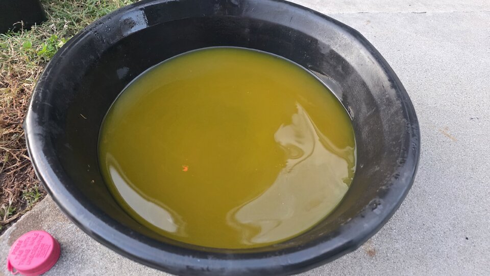

    Yes, I agree. It was def mixed with orange coolant or water at some point. Here is a photo of how it looked like: image.jpeg
    About a Gallon came out and about a gallon and a bit more went in. I was glad there wasnt any foreign looking sediment or jelling as you say which can also indicate head gasket “fix” additives to the system. It is nice and pink now and temp hovering within spec, so glad it was done on time. As for he flow/current in the reservoirs, is there suppose to be one in the coolant or inverter reservoirs like on the Gen 2? I didnt see any flow on mine, just steady coolant. And, as mentioned live data showed the water pump at normal operating speeds.

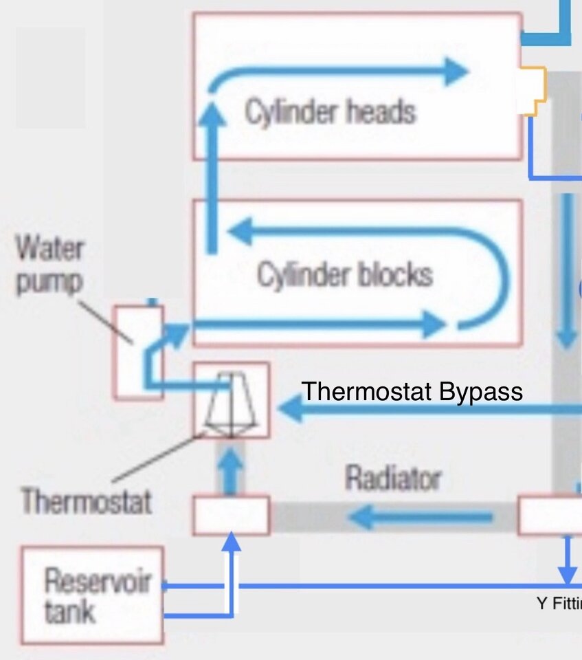

    Yes there is a good flow entering from the top reservoir hose once the thermostat opens. Flow before the thermostat opens uses the thermostat bypass inlet. Even after the thermostat opens a majority of the flow returns via the big radiator hose.
    Regardless there is a decent flow through the reservoir after the thermostat opens.
    Due to the somewhat opaque plastic of the reservoir, I place a small led flashlight directly on the top of the reservoir to light up the inside, making the flow clearer.
    A portion of the gen3 coolant flows (edited from a slightly different gen4 diagram)

    nasty!

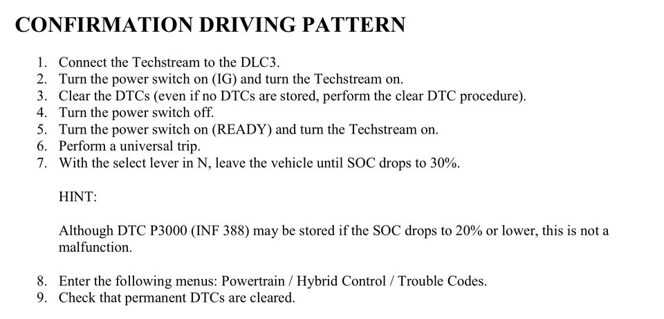

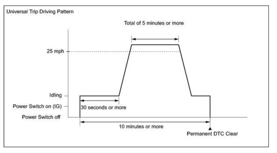

    You can try this:

  15. ChapmanF
    28,751
    19,056
    While the confirmation pattern mentions Techstream, by looking at the steps in the procedure, you can see that what you need is any capable scan tool able to view and clear codes for the hybrid system, and to display the traction battery state of charge so you can know when it is below 30%.
    If you don't already have any such scan tool, there are threads here that can help you select one. You could also seek help from someone who has one.
    ScottHz, PriuSocal and Brian1954 like this.
  16. rjparker
    rjparker Tu Humilde Sirviente
    Jun 6, 2008
    11,140
    6,985
    Texas Hill Country
    You do have to follow the procedure exactly even if a step seems unnecessary.
    Part of the procedure is a forced discharge of the hv battery to 30% which is low. Effectively a stress test. It is worth a try since it does not require a long multi day period of good battery performance to clear the battery permanent code, but some bad modules may show again.
    Under the 10 year 150k mile warranty, Toyota would replace the battery free with that code.
    While most of us warn against the poor value of "rebuilt" batteries due to very short lifespans, that may be a low budget answer if the confirmation pattern technique fails with the current battery.
    Even with a rebuilt or preferably a new oem nimh, someone would still need to run the confirmation pattern unless a receipt is good enough for the emissions testing.
    ScottHz and PriuSocal like this.
