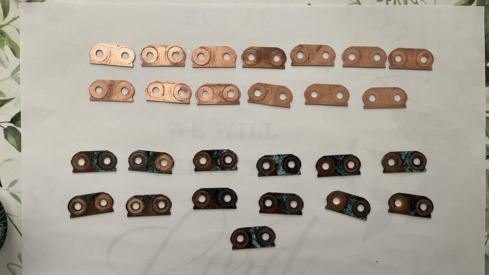

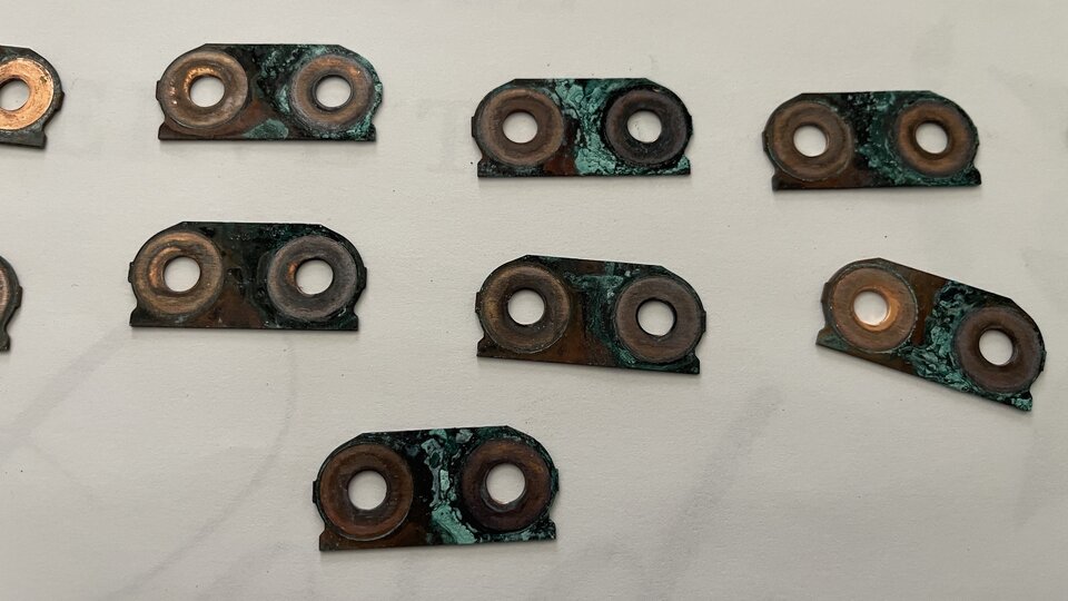

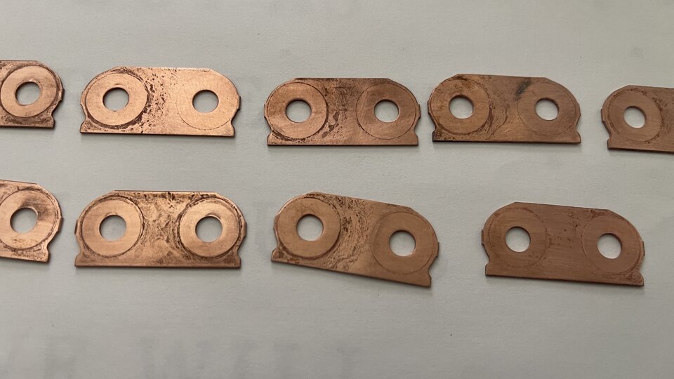

    They were definitely giving out different readings even at static as mentioned above. depending where I placed the probe, it gave out different readings due to the heavy corrosion. Only way to get the proper reading was to probe the tip of the actual battery terminal and thats how I was able to get proper standing voltage readings. I cleaned the front bus bars (top) and haven't done the rear (bottom).
    I a should be getting the new busbar/nuts kit today or tomorrow and will install them and very confident readings will no longer variate. If there was variation in readings due to the corrosion at static, I can only imagine while under load and driving.

    Yes, its is obvious now that the battery pack is not its original battery pack and was swapped out for an OEM used pack and then 3 modules replaced off that one. The car sat for over a year with just the occasional around the block drive by the prev owner.
    The nuts were tighter on some modules than others. I did read the busbars do burn out though hence the black underneath where the nut sits and that can also provide high resistance and false readings but putting it all back together will tell me more.
