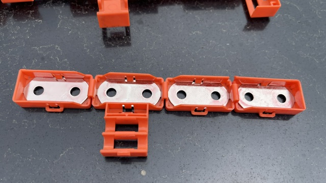

    I installed the new busbars and checked for continuity from plug to each connector on the longer busbar plate and they all are getting good conductivity. It is now ready to install. One thing I did check before doing is about the terminal spray protectant that you use on the 12v batteries and a google search shoed that it is NOT recommended to use on the busbars or cells due to it being specifically 12v isolated cells and can also introduce moisture to the connectors so I will be skipping that and simply relying on the nickel plated busbars and nuts to prevent corrosion.
    I also noticed this battery had missing busbar plastic protectors (the ones that cover the whole orange holder) so I ordered that and should be in today. Will post pics and update once it is installed.

    All has been put back together and initial startup was normal and drive was great, felt more responsive but it was only a drive around the neighborhood. Will be driving it today, monitor the battery and report.
    Nuts were torqued to 48 in-lbs per manual.
