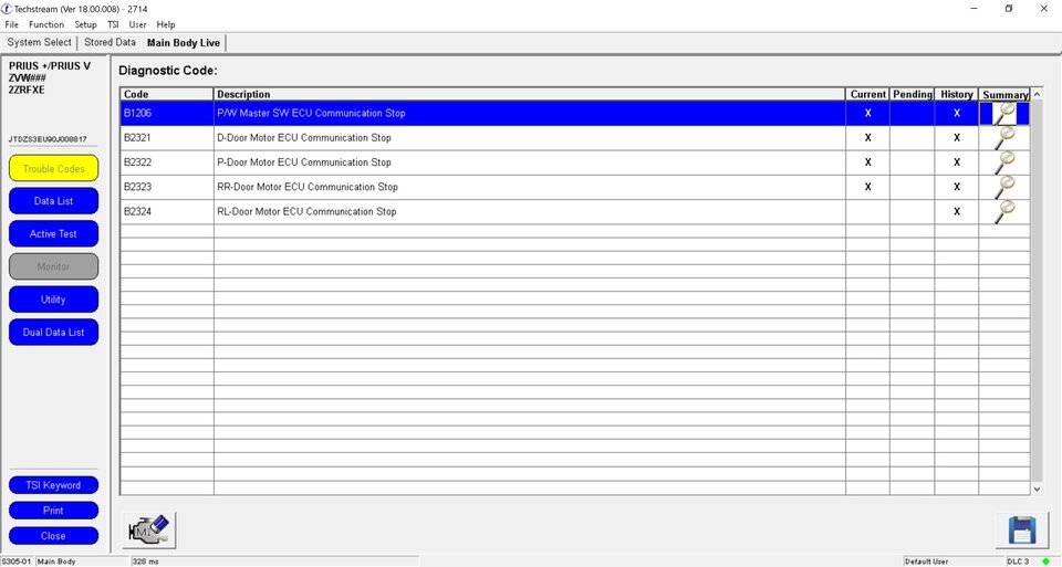

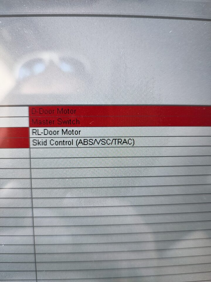

    I have run Techstream and as far as I understand there is no LIN communication, enclosed.

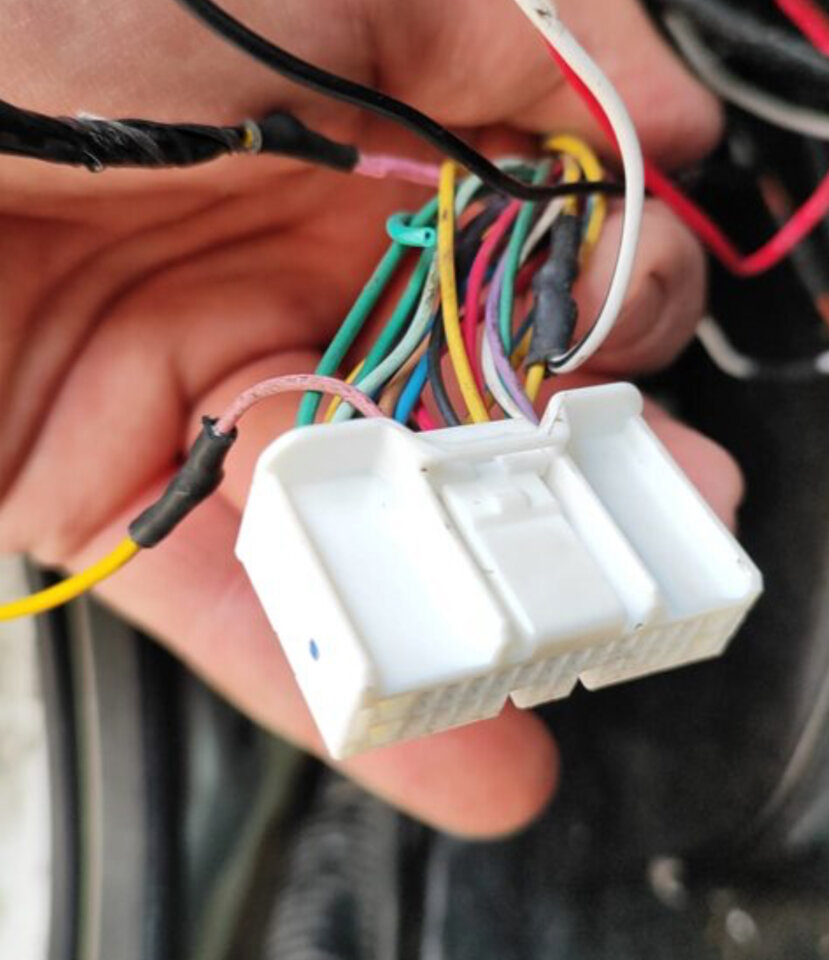

    3. In the kick panel I pictures the wires, what is black-white color wire? if some have wires color and their description , it will be very helpful.

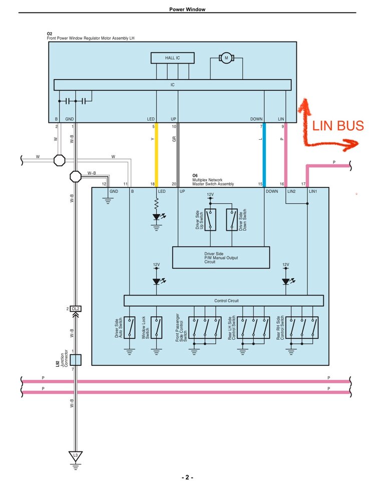

    There is no canbus to that switch. Only a single line Lin bus which is different. It is normally a pink wire.

    The Lin Bus goes through some connectors back to Pin 16 of the Main Body Ecu. It's pink all the way to the Body ECU.
    Yellow in the schematic I posted drives a led indicator.
    The other three window motor assemblies also connect to the same wire.

    Answer: The automatic windows closer was connected directly by wires to kick panel's wiring, this unit is faulty and I throw it away. Now, I purchased a new unit that is connected to other area (under the steering wheel), the new unit is also locking the doors after shifting to "drive".
    Sorry for drilling down: after removing the door cover panel the power windows switches are connected to the door connector. The door connector wires goes to the area of the kick panel. The kick panel is the area where I disconnected the automatic windows roller and bridged the wires.

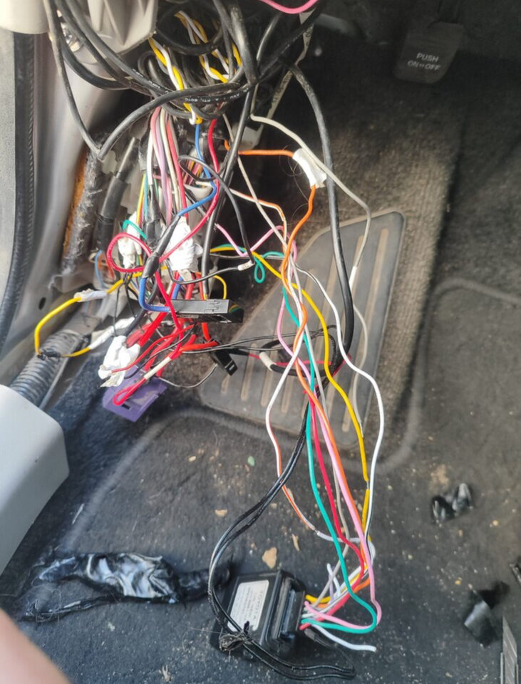

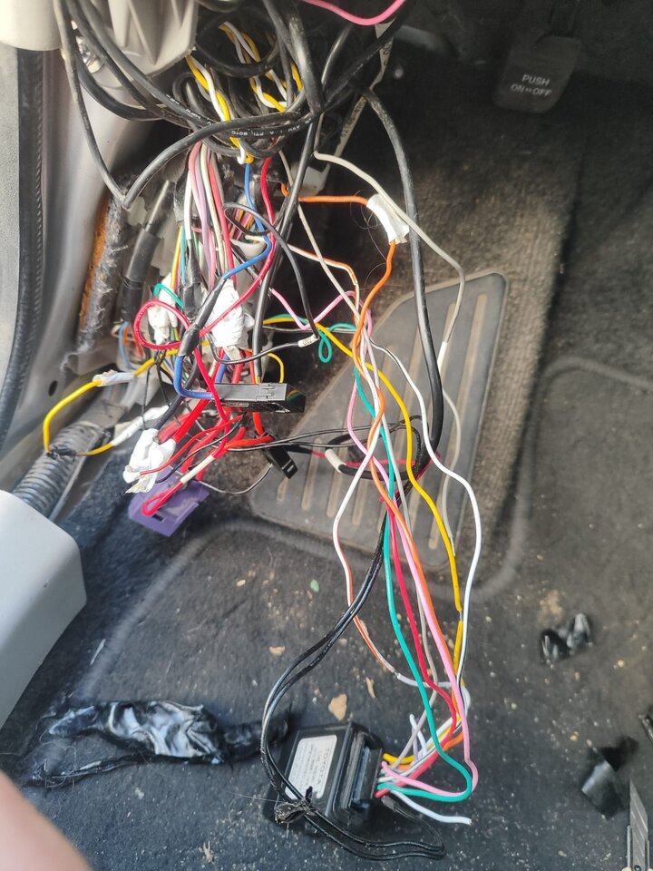

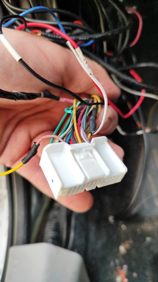

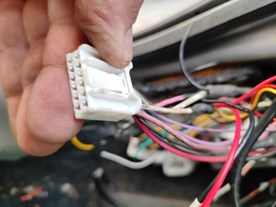

    Enclosed 2 pictures of the old automatic windows up roller (with directed wires soldering).

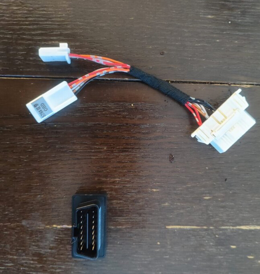

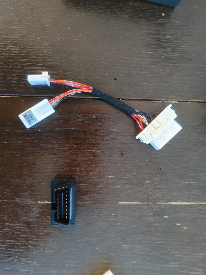

    Enclosed the new module with plastic connectors.

    It looks like some optional module (not original factory) was added by splicing into the wiring harness.
    It would be useful to have a clear picture of the above module's label. I can see Toyota but the factory would not have installed it that way. See below.
    Kind of wonder if it's a security add on and not just a window closer. It is very possible the previous device needed the Lin bus, power and ground along with other connections to suit its purpose and therefore was manually wired in. You disconnecting it may have broken the Linbus connection.
    Other wires a security addon may have tapped includes things like door locks and lights. Having the original device's install instructions would help in properly removing it and restoring the wiring to factory. As is we don't know for sure what it was and or what was its function.
    This following pic is certainly an obd2 device or addon connector. You can see OBD on the label and the big connector is obd2 style. Where did you get it and who said this is what you need?
    Assuming the old and new modules are some addon device, normally they would come with their own wiring instructions.
    Sometimes newer addon devices will use a car's obd2 diagnostic port to add features or to enable data monitoring or data collection. The obd2 port has 12v power and ground and has the vehicles Canbus on it. Normally the Lin bus is not on the obd2 port.
    I would get back to the seller of the new device and ask for instructions. Plus find the instructions for the old device.

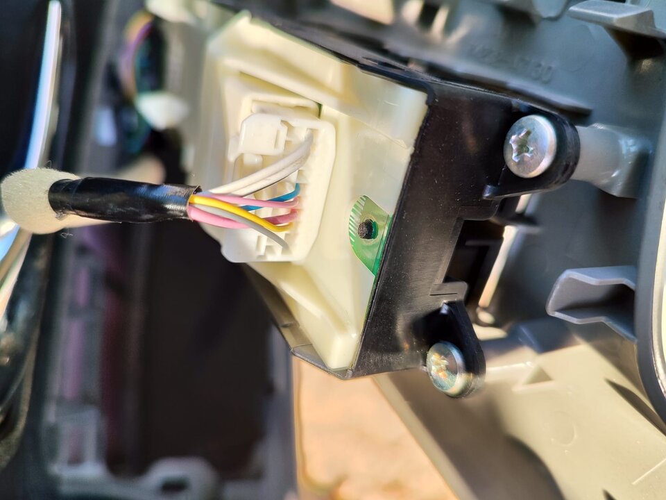

    1. I checked my multiplexer switch on my friend's prius V car, it works fine there. I returned back my friend's multiplexer back to his car and now he got the same issue:
    *Controlling driver's windows without power window
    * not controlling other passenger windows
    * not controlling lock unlock button.
    * No light on the windows indicator, only on the driver window indicator if I press up/down and that after few seconds light dissapear.
    * each passenger control its window, even power window works
    I checked voltages on the multiplexer:
    white 12.7 V
    pink 12.7 V (lin)
    I tried press on the multiplexer up or down on every window and to measure Voltage, there voltage remains 12.7 V on the lin.

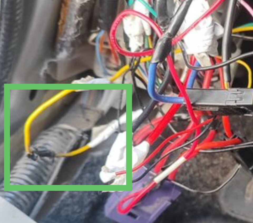

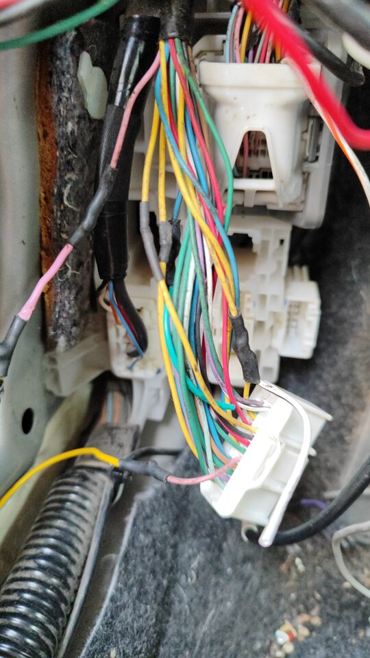

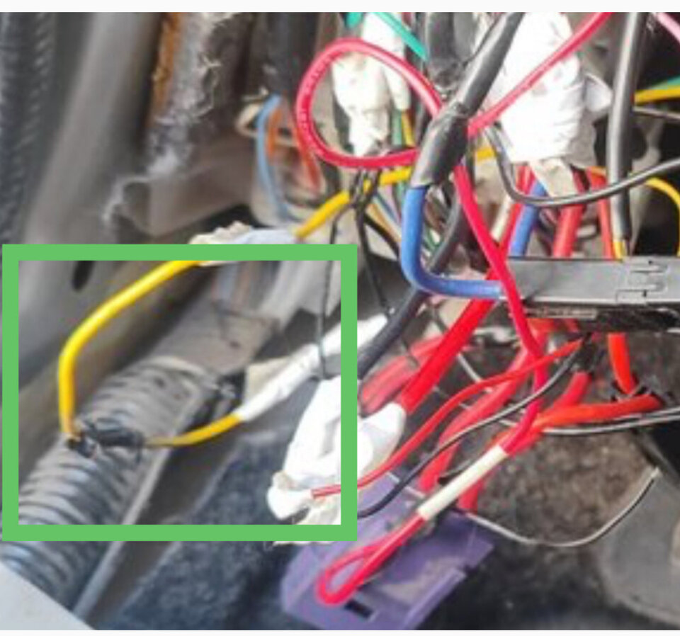

    I rewired and welded the kick panel wires.

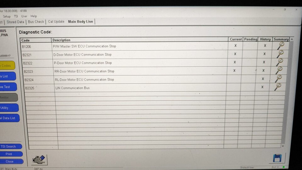

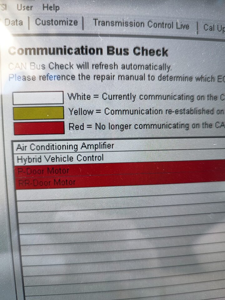

    Current tech stream pending codes, enclosed

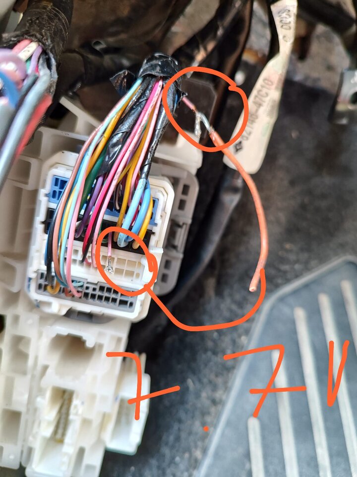

    6. There is pink wire in the kick panel bridged to the BCM with 7.7V, enclosed. what can be the reason?

    My first thought is something in your add in wiring is burning up the window control. Now you two bad modules.
    If I was hired to fix this I would remove your "automatic window closer" since the new one is different than the first which could be burning up your factory control.
    I would reconnect the factory wires exactly how they were originally. Before powering up I would probably ohm out any cut or spliced wires that have any chance of being confused.
    I would then test and when the Lin bus still did not allow the master to control
    the other windows, I would buy two more, one for your friend and one for yourself.
    Note the Body Control ECU has the can bus and communicates to the windows using the lin bus. The master drivers window communicates to the other windows on the lin bus.
