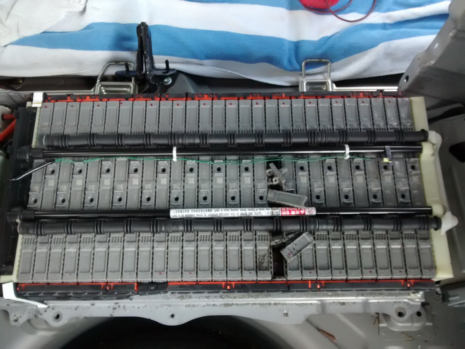

    It rained quite a bit last two days and I had on the lights, defogger, and wiper at the highest setting and the energy level went down from 7 to 2 in less than a minute. Turned off the defogger and set the wiper to intermittent setting and thankfully chs warning didnt come on. Also, this never happened before where the energy level showed 8 bars but since the chs first came on last year, several times it went all the way to the top. I guess it means not good. upload_2018-6-22_18-41-1.png

    Yes, as you've pointed out correctly this is the car subtly telling you it's sick. That battery is doomed. It may last another year though you just don't know. Lots of people, myself included, have run such sick Prii vehicles for 2-3 years before the actual failure lights come on. And in my case, I ran for almost 8 months after that before I replaced a module with just clearing the codes more and more often.
    If you love the car and want to keep it, start saving for a new pack. Either new from Toyota or new from me. Don't even bother with reconditioned/refurbished.
    If you are looking for a new car, now would be the best time to trade it in. When the dash lights up like a Christmas tree, the trade-in value takes a huge beating.

    An actual failure looks like your post #21 at the top of this page. I still wonder about intermittent connections, maybe corrosion on the battery, as an expended battery doesn't have the capacity yours seems to have when it it working. Also, I would expect a few more years out of a 2010. However, if you swap it out you will fix any corrosion. ;-)

    Just re-read that you already had a failure 10-months ago. You're on its last legs then undoubtedly and the value has already dropped. So either keep it and fix it or sell it as junk.
    You should have seen this battery behaviour for the past 2-3 years just getting gradually worse and worse and worse. Then you get the code you got 10 months ago. You're driving on borrowed time. Eventually the codes will come back. And you will have to clear them weekly to keep driving, then daily, then it just won't move. Other faults like HV Isolation faults can strand you anywhere so make sure you have an OBDII reader/scanner/clearer with you. Driving on a known bad battery will make it run hotter. This can lead to the pack exploding, in the sense that the vent tops will forcibly blow off and release gas into the car and potentially the entire pack will start to deform and warp the assembly.
