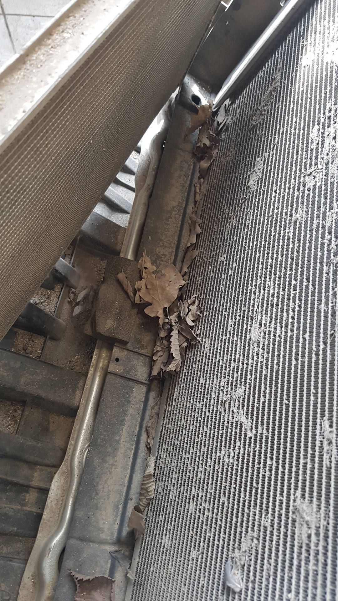

    If you are driving at high speed and the coolant becomes overheated, please follow these steps.
    1. Carefully inspect the front end for coyotes and other roadside animals.
    2. Inspect the outside of the radiator for dirt and fluff.
    3. Unscrew the radiator mounts. Oh yes! Two radiators! Like a sandwich. And between the radiators there may also be a large layer of lint and dirt that requires cleaning.
    4.Rinse the radiator; fine sludge may accumulate inside and clog the internal radiator tubes.
    5. Replace the coolant pump. The design defect of the pump is that at high speeds and high temperatures, deformations or cracks appear in the plastic housing of the impeller drive. Its functionality is impaired. And it can jam against the body and not give the required number of revolutions for the intensive movement of coolant.
    douglasjre likes this.

    A few months ago, I took several steps to address cooling issues with my vehicle. I removed and cleaned the radiator, flushing it with tap water and power-washing it thoroughly. I also rebuilt the water pump by replacing the rotor with one I ordered from Amazon. Additionally, I rebuilt the radiator fans by cleaning the motor brushes and replaced the thermostat. When these efforts didn’t resolve the problem, I replaced the water pump (Aisin from Amazon, everything works after the install). Since I'm still encountering issues, I’m planning to conduct a leak-down test and have ordered a new radiator along with water wetter. If these measures don’t solve the issue, I’m ready to consider further modifications, such as installing an auxiliary pusher fan (which will probably just increase turbulence and not help during freeway speeds), fabricating a custom two-row radiator (this is what I think will fix my overheating issue), or modding the bumper for increase air flow (this is a cheap and a really good plan). If you have any additional tips or suggestions, I’d greatly appreciate your input. Thank you!
    When I was rebuilding the water pump, I replaced the old rotor despite it not showing any scratches or visible damage upon inspection.
