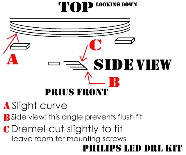

    I have a Model 5 Prius also. How white are drive lights compared to LED head lights. I know if wired correctly they will not be on at same time but was just wondering. And can you show picks where u hooked up wires for power and for auto off - turn signal

    Can we get a close up picture of your work. :) Thanks for your help.

    Hi XMAN Live,
    Here are some closeups:

    Doesn't follow the lines of the car. I wouldn't do it.

    thanks!!! 4 the pictures... Good job! any pictures of where you hooked up your power :)

    12v Tap for DRL LEDs Engine Compartment Fuse Box - (Black Wire corner of plug) Measure with Volt Meter to be sure! I started, stopped, and turned if the car to test + plus turned on/off head lights/parking lights
    "Sense" tap was White/Blk side Marker Light wire (on drivers side)
    Verify these with a volt meter. it has been a while since I installed them for the WebElectric DRL's.
    -Zed
