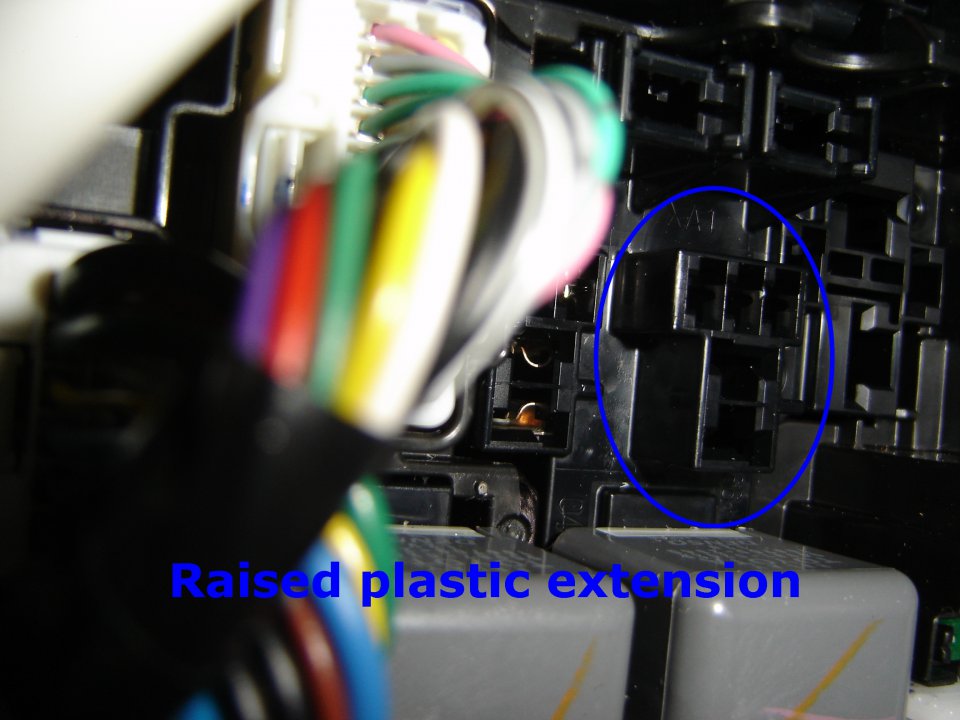

    Took a picture of the fuse box. The circled slot was suppose to be for the DRL relay but the plastic has been extended up. I'm suspecting it was intentionally made that way so you cannot plug a relay - relay plugs will become short and no contact can be made. I looked at some of the relay for DRL with 5 pin connector and they run around $18-20 shipped. I was thinking that this plastic extension can be easily modified by cutting it with a dremel tool to shorten it so a relay can be plugged in there. In this picture, I took away the relay beside it that is present in our V's so to have a good look at the slot.
    If there are Canadian owners that will share the picture of their fuse box with the DRL relay taken away for comparison, that will be great.
    jzchen, why not go to the local Toyota dealer and check out their fuse box? I know it is a hassle. But it will be a good try.

    I'm outside AAA waiting for them to open. It doesn't show on my phone, but I suspect your car is not a wagon. I think you can just push down on that relay slot. My empty slot is not raised. It is not populated with connectors. The thing is it would be very helpful to confirm the relay part number on a Canadian model. I suspect the high beams are run in parallel for high beam and serial when in DRL mode. I don't know if the bulbs allow to reverse the positive and negative, but it would make things a little easier to wire as well. I hope to not be shy and call the dealer today. A Canadian dealer quoted me over $400 for the relay, but wisely gave no part number....

    I have the wagon and the picture was taken from the wagon.

    Hmm. Is this the underhood fuse box towards the driver side? There are three relay slots in a row on mine towars the front of the car. Two are populated. One is DRL/DRL Module, one is FAN, and one just says DRL, which is empty. I'll verify when I get home...

    For some reason that is not the same fuse box. Here's a picture of mine:
    http://i771.photobucket.com/albums/xx353/jzchen2276/Prius%20v%20DRL%20attempt/20130522_103320_zps666ab74b.jpg
    They are definitely not the same....
