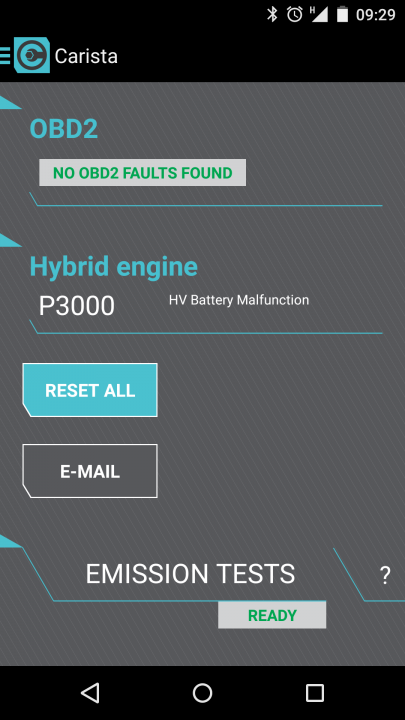

    Okay, so I bought one of those OBD2 readers and plugged it into my Prius and used Carista on my phone to run a diagnosis and fault code search. It came back with the engine being fine however it's showing a fault code P3000 for my hybrid engine/battery. I'll have to ask the dealer to take a look at it. Hopefully it doesn't end up costing a fortune as my hybrid seemed pretty healthy until it took that bump.

    First thing before worrying about any fault codes is to ensure your 12v battery is healthy. If it isn't it likes to cause all sorts of weird and wonderful messages to appear.

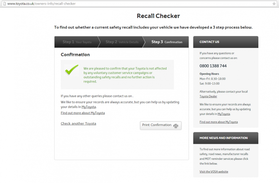

    If it is healthy then I trust you had the inverter recall carried out early last year? Not sure? Check this; Recall Checker | Toyota UK

    Thanks for your advice. I'll have to purchase a volt meter and check my battery like you and others have suggested. Thanks for the link to the recall checker, it hasn't found anything for mine I'm afraid.

    The recall was to reprogram the inverter software as early gen3's had a tendancy to fry the inverter. I know that because mine did exactly that at about 71k miles. It was outside the 60k mile warranty but Toyota replaced it for free. I think they knew there was something going amiss with inverters as others had reported similar failures, though usually at higher miles (the car was only a couple years old at the time). Since the new inverter and software recall the car is just as economical as before, maybe ever so slightly more so once it had settled down, BUT it doesn't have that amazing whoosh of acceleration in Power mode that it once had :(
