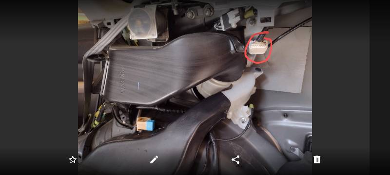

    As mentioned, there is a common fault on the Gen2 Prius. There are often water leaks around the top of the tailgate opening, where the body seam sealant cracks. The cracks are around the tailgate lift piston mounts, and extend up into the channel on the roof, under the black strips.
    Water dribbles down inside, and corrodes a white connector on the right side. That connector has circuits for the cooling fan, and the fuel pump.
    The usual repair is to cut the wires and splice around the connector. Then clean and reseal the body seams. Screenshot_20240317-213122.jpeg
    Prodigyplace likes this.

    There is also a connector where you don't expect it . . . . under the left panel looking from the back where you can also get corrosion.
    It took me ages to find that. unfortunately, I didn't take a picture of it at the time. Here's a video of the connector on the right:
    I can't find one showing the connector on the left hand side.
