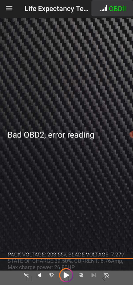

    The "Bad" message partially visible on the screenshot reads "Bad OBD2, error reading". Not sure why this error message appeared, but it did so both times after I ran this test.

    To my novice eye, tests seem to show 20+ year old original HV battery with 66,000 miles seems to be doing vey well for it's age. Interpretations and comments from others with more experience with this app are welcome.
