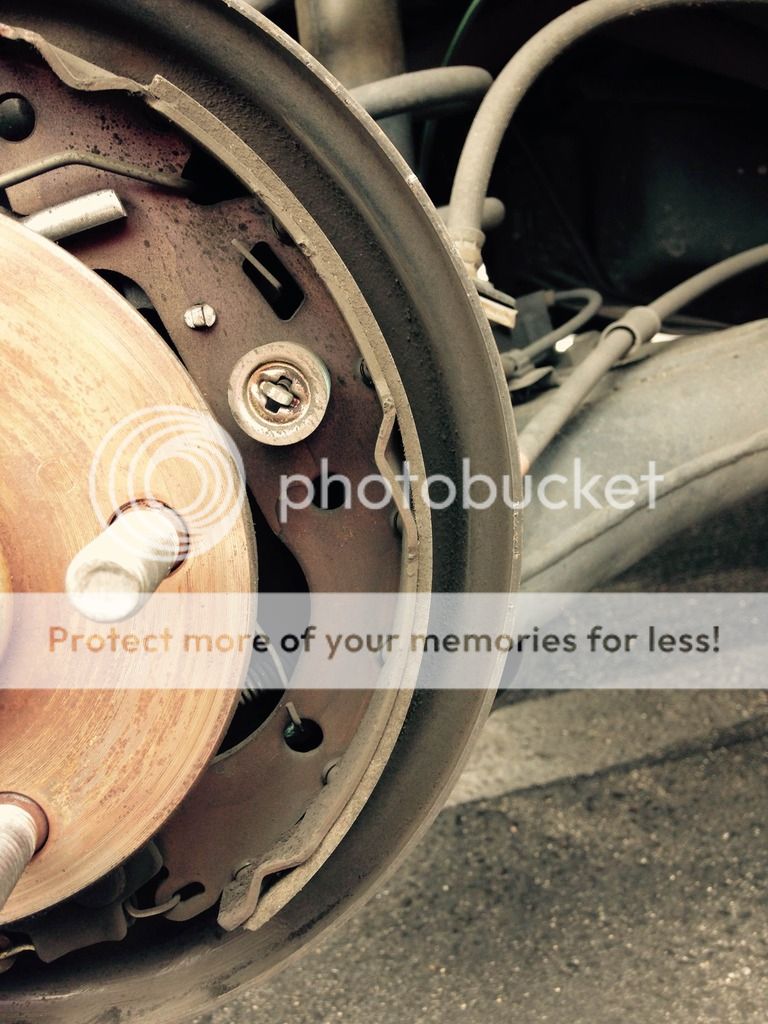

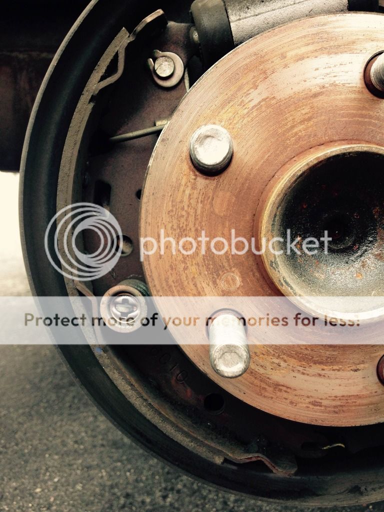

    I have a 2006 Gen II Prius with 120k miles. I recently removed the drums on the rears and want to know if I should replace these shoes? These are the original brakes, the front pads look about 60% worn. Please advise...

    They look fine, the shoes look like they are about half worn.

    The new brake shoe lining is 4 mm thick and the spec for replacement is at 1 mm. It looks like you have plenty of lining thickness left. There is very little reason for the rear brake lining to wear unless you leave the parking brake engaged while driving the car.
