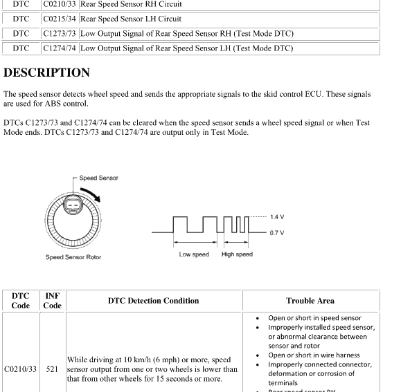

    Just for my personal knowledge, is this part of the repair manual the "troubleshooting information"? From the repair manual, C0210/33 lists the following under Trouble Area for INF code 521
    Open or short in speed sensor
    Improperly installed speed sensor, or
    abnormal clearance between sensor and rotor
    Open or short in wire harness
    Improperly connected connector, deformation or corrosion of terminals
    Rear speed sensor RH
    Brake booster with master cylinder (Skid control ECU)
    What I'm asking is, for example let's say I do in fact have an open or short in the wire harness. Is there further troubleshooting information on how to detect that in the repair manual somewhere? Some section like, "Use a volt meter between pin X of wheel harness and pin Z of skid control ECU. If open circuit, replace wiring harness." Or am I supposed to do my best troubleshooting given "Open or short in wire harness" as my start.
    The is the first time I've cracked open the repair manual, so I'm unfamiliar with how detailed they get & if I've found the right place.

    There are two places in the repair manual where you can find a list like that. The first is just the "diagnostic trouble code chart" at the front of the brake section, just a big table of trouble codes one after another, shown with their fortune cookies and trouble areas. That place doesn't help you very much.
    The "troubleshooting information" for C0210 is the section that starts with a page like this and goes on for thirteen more pages of steps you can follow to troubleshoot the problem:
