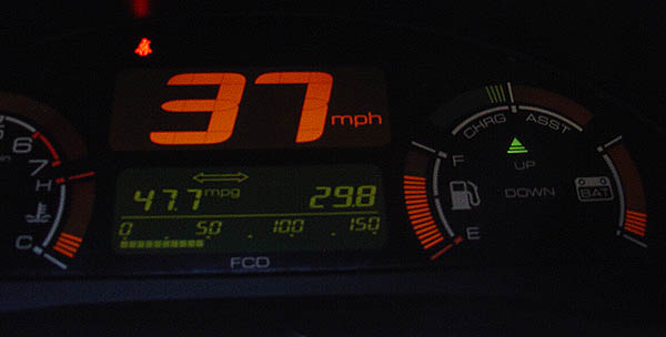

    This is a picture of my Insight on a typical recal (guys at the body shop ran it down, but I have to blush at not having put my seatbelt on at that time)
    I'll try to explain:
    The green instant mpg bar would typically be at or just right of the notch between 50 and 100 (i.e. 75-80mpg) Everything changes on a recal as you are knocked out of lean burn because of the load of forced regeration (recal). That typically pushes the mpg to 50 or 40. Note just over the upshift arrow the four green bars - that's a forced charge. On the far right of the picture is the State of Charge or SoC bar. Typically, when it's slighly over half full, it recals, going to one or zero bars in about 30 seconds.
    The early 5-speed Insights and Civics seem most vunerable to battery problems - heard less problems with Honda hybrids with CVT transmissions. Recently Honda has made recalls to upgrade the software. Believe the key thing is doing a recal at 40% charge - not 15% to extend battery life.
    Back in Feb at 94,000 miles, Honda paid $6,000 in "good will" to replace my batteries and two black boxes - I paid $450. It works better than when it was new - almost have to intentionally get it to recal these days. Honda really did not explain anything to me but just replaced it all.
    My general statement to hybrid Honda drivers is if a recal happens no more than every three months - excellent. Once every month - good condition. A recal every week or more - caution. I advise against heavy draining of battery packs on any hybrid - I'm talking about 30 or more seconds of assist on Honda's. In those situations, DOWNSHIFT - it's not worth it!

    I don't think that 5-speeds and hybrids are a bad mix per se. The problem is when they are lugged (or close to it) the assist is on for an extended amount of time. It's a lot better to use lower gears for acceleration. While the Insight has respectable acceleration, they are not for those that are wanting a sports car.
    This is why Honda no longer makes 5-speed hybrids - got to cover your back side from misuse.
    Thank you for the CleanMPG mention - Tony. My recal pic is from there....
    IMHO, Honda's hybrid battery problems would have dropped dramatically to the point of being a non-issue by doing two things:
    1. Do a forced recharge at 40% instead of 15% on the early models.
    2. If they offered 5-speed hybrids, generously warn against shifting too high. They could have engineered a downshift arrow in those situations. The safe thing would be to just not have hybrid 5-speeds, although I thourghly enjoy mine.
