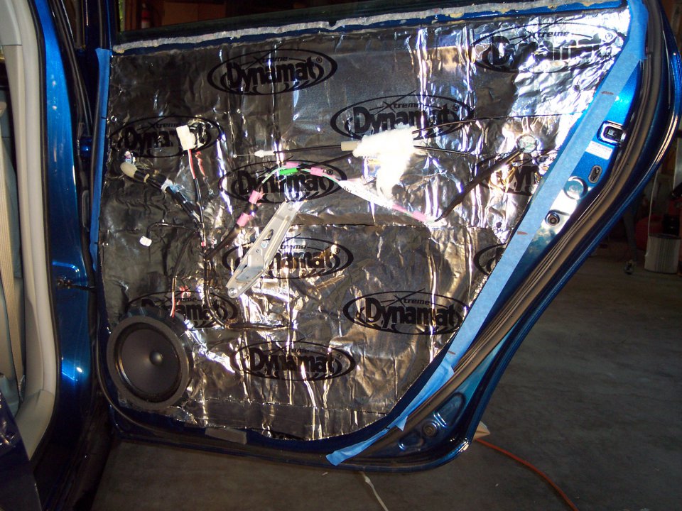

    engerysaver: I also did the doors (all 4 but only the passenger RF is shown) in Dynamat and the sound deadening effect was much more dramatic than doing the flooring:

    The doors make lots of noise, because Toyota does not sound proof them;:( Other than a thin plastic.:mad:
    Your door looks great!!(y)

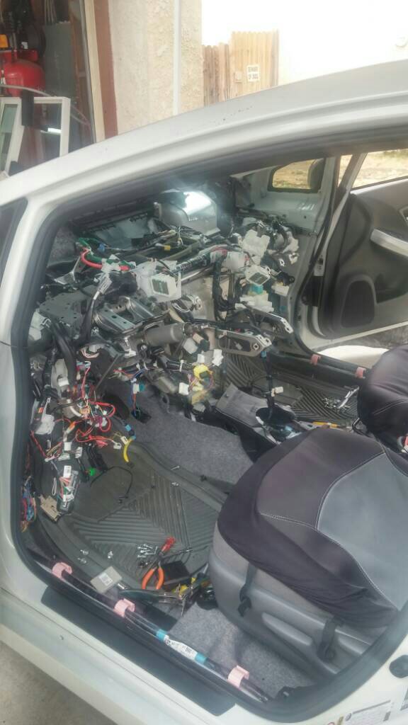

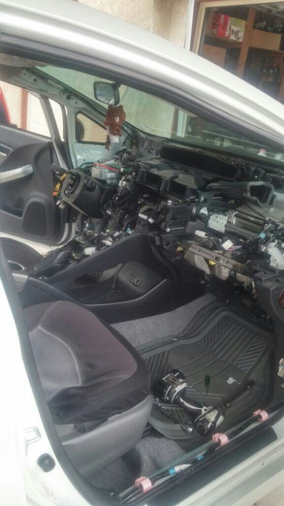

    Something like this?
    VS980 4G ?
    MarsMan likes this.

    whhhooa... what a tear down, awesome!
    just my two cents...
    i would recommend deadening that part in the photo of the "little window" as i can hear some rattling and hissing when travelling. couldn't do mine yet cos of the weather but i intend to tackle that next.

    wheel well muffling 012.JPG wheel well muffling 013.JPG wheel well muffling 014.JPG wheel well muffling 015.JPG Dynamat wheel wells 001.JPG Dynamat wheel wells 002.JPG Dynamat wheel wells 003.JPG Dynamat wheel wells 004.JPG Dynamat wheel wells 005.JPG sfv41901 Wow! I've been behind my dash but never saw a teardown like this. Add to that, this guy was not even near getting at the firewall on the inside. So my belief that doing sound-deadening there is nearly impossible. If someone figures out how to do it from underneath the chasis, please post pics and instructions. I've uploaded some pictures of my wheel well muffling project using dense foam rubber. It worked pretty well. Then after putting back the wheel well assemblies, I added Dynamat to them (exterior) and painted it all flat black. Again, some more improvement on the transfer noise from the road.
